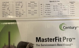

New motor info - New motor
Old motor info - Old motor

When thermostat is switch to the on position it turns on the air conditioning fan speed usually hi speed. In heat no signal from thermostat with a gas furnace a fan control takes over normally by temperature. About 120- 130° turns on and off 80°. How many wires going to the old motor and colors? How many from the new motor or pic of the motor tag 7 wires? Buy a capacitor? Can't read your wiring diagram with me tablet can't blow it up will have to fire my computer up. Normally two brown wires go to the capacitor, white to white, black to black and yellow or orange to red- furnace. All unused wire nut or tape each wire separately.

Thanks Fitter for the help.
Old motor (1/2hp): Brown x2(capacitor), Yellow(fan), White(neutral), Red(heat), Blue(m2), Black(cool)
New Motor: Brown, Brown/White, Yellow, White, Red, Blue, Black, Green (all plugged into the same places as the old one)
I've let the furnace run for about 3mins and the blower motor never kicked on. I figured it wasn't safe to leave it going for too long. Should I try longer?
The new motor came with a capacitor so I switched it out. The old cap was 7.5v and so I hooked up the new cap to 7.5v as well.
The original wiring had yellow on fan, Blue on M2, Red on heat, Black on cool, White on neutral. I've hooked the new motor up to the same colors. Both browns go to the capacitor and green is grounded to the casing.
Edit: The wiring lists the following colors / speeds:
Black - Hi - Cool
Yellow - M-Lo - Heat
Blue - M-Hi - M2
Red - Lo - Fan
Edit 2: I tried switching the red and yellow lines. The blower motor doesn't kick on anymore when fan is set to on. The A/C still doesn't respond (but I guess it shouldn't help with that anyway). Blower motor doesn't kick on for heat either.
In all 3 cases I do hear an electrical click like its calling for it but nothings happening.
