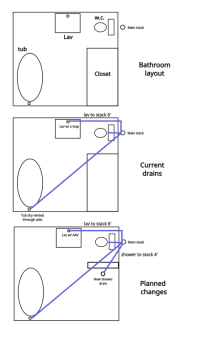

Hi all,
I'm adding a shower to a second story bathroom that currently has a tub/wc/lav. The plan is to make room for the shower by pushing out a closet from an adjoining room. I haven't done the demo yet, so it's light on details.
I've got two questions:
- Do I need a separate vent for the shower? It's <5' from the main stack, and there's nothing above this floor, so I think the answer is no.
- Does it make sense to use an AAV for the lav? It's currently using an s-trap, and it's in the center of an exterior wall making it hard to vent.
I've attached and image of the current and proposed layout, and I'm located in Ontario
