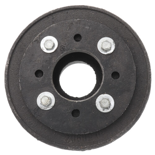

Have you thought of having a plumber make a lead pan to fit in the space and then they can set the drain right where it is??
Use a cast iron riser connected to the PVC with a no hub coupling and buy either a Jones spec or JR Smith cast iron Quick set shower drain and the plumber can make a caulked joint or use the Quick set where the bolts are tightened
