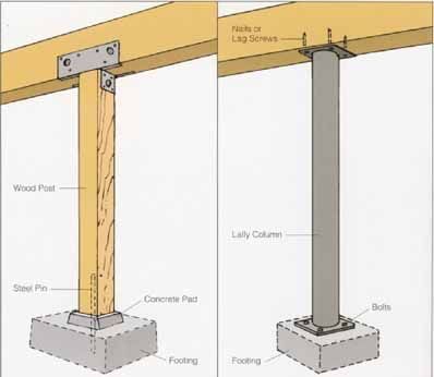

- The basement has a winding staircase that basically comes down into the center of the basement. In the portion of the basement where the stairs are, the floor joists run from the foundation sill across and then are supported at the stairs by notches at the end of the joists that sit on top of what looks like a 2x3 nailed flat against the framing of the stairs (see the second picture). This doesn’t seem like a good setup to me at all, and I can’t imagine it’s to modern code. To make things worse, right above the floor joists that are supported by this notched connection is our first floor bathroom with a bathtub that we use regularly for our kids. Is this something that I should correct, maybe by building a short load-bearing wall right in front of the stair assembly for the joists to rest on? The only thing that makes me feel better is that this setup is clearly original to the house and has stood the test of time for 65 years.

A 2x3 nailed ledger and notched ends is a valid way to hang joists onto beams. If it looks like the ledger could be pulling away from the beam you might throw in a few 3" lag screws every few feet for insurance. It appears the beam is not fully spanning, but if ends are anchored in a doubled-up full span joists it may be structurally adequate. If not, a steel lally column (cut to length, no need for an adjustable type) can be added to the otherwise floating end of the beam. A concrete filled steel post is pretty easy to box in, easier than building a structural studwall, and adds a lot of structure. If you're unsure of the slab thickness there, pour yourself a ~1' x 1' x 3" (or taller) footing/pier on top of the slab to rest the lally column on. If the slab is at least 4" thick that's usually not necessary, but you'd want to remove the tile where the column rests, since the tile will crumble over time if the house settles or moves a bit. If it were a bigger beam supporting a load bearing wall above a bigger footing would be in order, but I suspect a square foot of 4" concrete is plenty in this case.
About a decade ago I added a lally column to a less than perfectly supported beam at a stairwell to my 1920s vintage house as insurance. In my case the slab is an unreinforced 1.5 - 2" rat-slab that would be prone to cracking under the load, so I went with ~3" tall 12" x 12" concrete footing. There are full span beams original to the house in other parts of the basement that are supported in the middle with steel lally columns on similar sized above-slab piers/footings.
