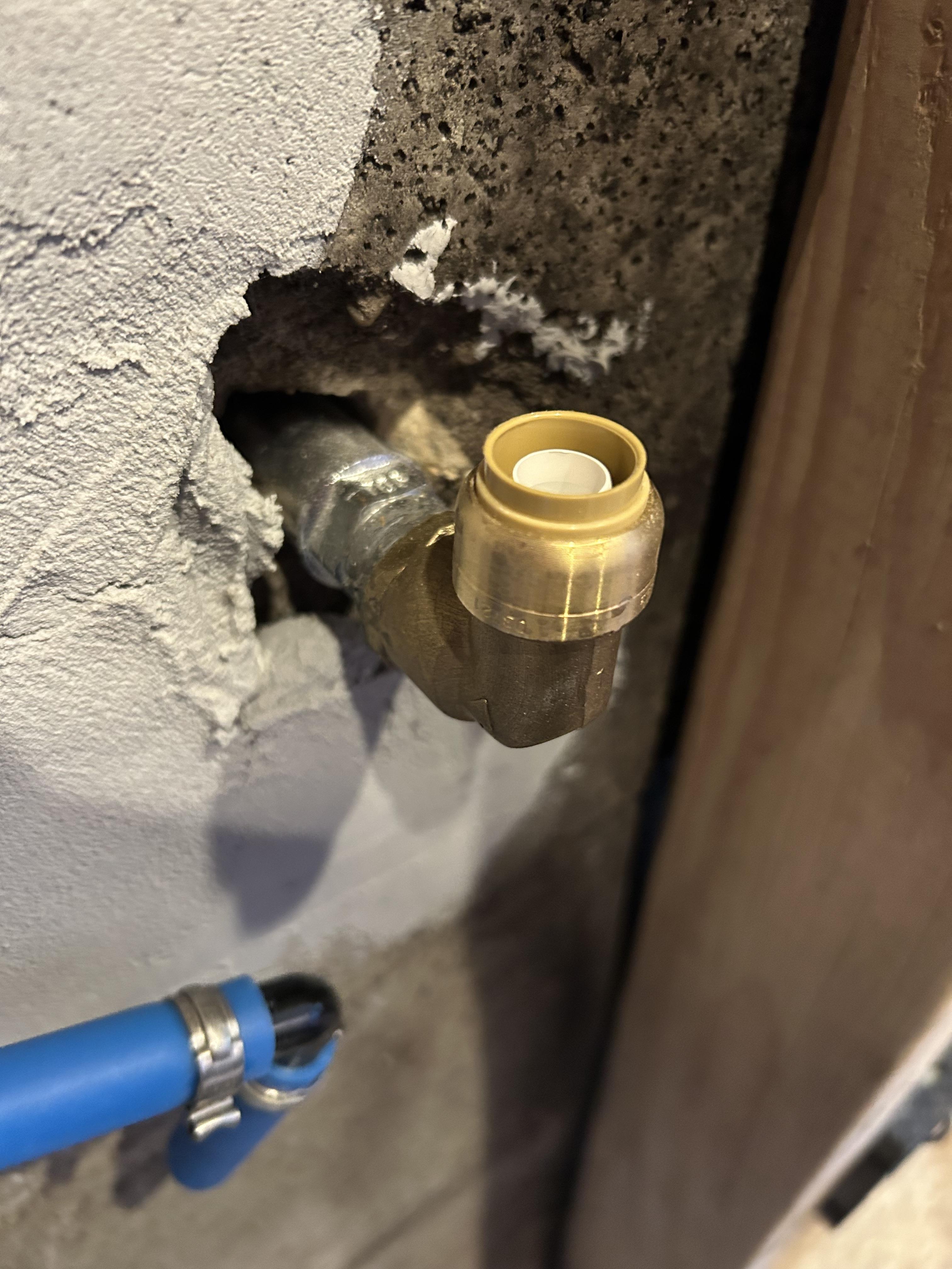

I did check the existing threads, and I'm pretty sure mine is different. I'm actually just looking for some confirmation to my conclusions, but I'm also here to be learned
In our home 2 of the existing hose bibs are both plumbed 1/2" PEX. They come off the 3/4" PEX at varying distances, but are within several feet. 1 has a no-frost and the other does not. They both scream water. I filled a 5 gallon bucket from the normal bib in less than 30 seconds. I haven't tried the other one, but last year it worked the sprinklers, hand sprayer, etc just fine.
The 3rd one is part of the apartment that flooded from a pin hole leak, so I replumbed it in 1/2" PEX.
This morning, using the same 10' hose section, it took 1 & 1/2 minutes to fill a 5 gallon pail. It has a 1/2" 1/4 turn shut off before it goes into a frost-free bib. Leading up to its exiting the house there are 9 PEX plastic connector elbows, etc including 1 Sharkbite push fitting going to the frost free. Lots of friction, eh?
I even attached a flex hose to the water from the kitchen faucet valve which is the typical 1/4 turn 3/8" compression. It filled the 5 gallons in less than a minute & a half. The problem hose bib Tees off of that pipe.
My plan is to go downstairs to the 3/4" supply where it's closest, (about 20-25 feet total) Tee off of it with 3/4" PEX pipe & brass PEX barbed fittings so I can Pinch clamp them with my Ryobi machine. I'll do bends where/if possible, and just before the foundation exit I'll install a 1/4 turn 3/4" PEX shutoff, with easy access for winter closings. I'll do a simple 3/4" sillcock with no frost free.
Am I on the right track? Before the leak there was never a problem with the 1/2" copper pipe & sillcock.
Thank you in advance for your wisdom & experience!
