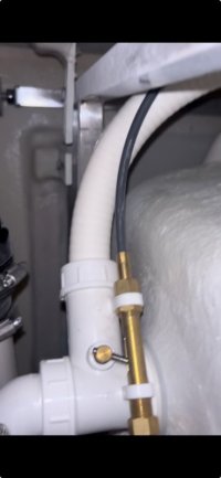

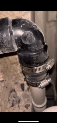

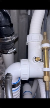

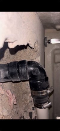

Today I had a plumber come by and look at my tub. He had to cut another hole through my wall to view the drain. He said that the jets are connected to the drain (despite your guarantee that they are not!) He took several pictures and a video showing the connection between the drain and the jets. We ran water in the tub while he was here and there is absolutely ZERO evidence of any water leaking out into the desert sand.... however water was draining very slowly out of the jets when the drain was plugged. Unfortunately he said he would have to tear up my wall and new LVP floor in order to repair this Drain-Jets connection. The other access panel is on the motor/pump side of the tub. Sorry the video that clearly shows the Drain-Jets connection says that the file is too large for the server to process.

All bath tubs have a drain and overflow the black pipe goes to the ptrap the white connecting to the black is part of the drain . I see no evedence of the jets (which are 100 percent of the time indepedent of the drain ) being interconnected but yours I guess is the first. further Ive never heard of a drain -jet there is a drain and there are jets pressure and suction piping . thats just my experiance probebly installed around 100 I dont build them Ive fixed some leaks (a few) but nothing remotely close to what you are saying. the abs work with a vent 90 a bit hokey but I wish you would point out where the jets connect to the black pipe.
the brass pieces with a cable operate the drain something must be wrong there

Im a licenced plumber who understands jetted tubs . and so is Breplumb. Yes you said it multiple times but it still makes no sence . Your jets go straight down into the drain evedently downstream of the stopper assembly? . I just want you to know there is a pump that draws water through big round cover with holes in it in your tub then goes through a pump and gets blasted back in through the jets inside the tub. thats the end of the story normaly, and the tub is pre plumbed at a factory So us plumbers dont touch any of that.
Sorry for your nightmare but I cant see anyreason such a screw up would occur . Id like to see the video but dont feel real comfortrable sharing that on the site a bit paranoid I guess.
maybe put your video on you tube still shots were bad too I did notice an improper fitting the black vent 90 is wrong under there but not causing issue it might prevent cleaning out easily in event of blockage
