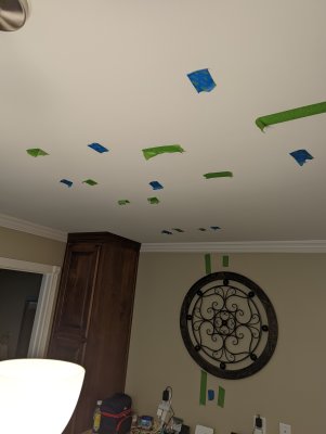

Been fighting some what I think are bad copper fitting as I try and redo the copper around the water heater. In the mean time the Pex was support to be delivered 2 days ago and they screwed up, some hopefully Tuesday now. Drilled some of the new holes to route the pex in parallel. My plan is to get as much run in parallel so that the cutover can be quicker.
Here are the pics of all the prep do far.
