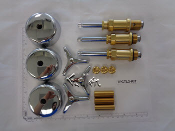

Thanks for the hint. American Standard is correct.
My hardware is original from the mid 1950's, and is in need of renewal. So either a new hardware kit, or a new replacement valve assembly. My tankless water heater works great with these valves. Mostly hot water for a shower, and just a trickle of cold water.
For future use by others, this is what I did to find the correct complete rebuild kit.
I searched for three handle tub shower American Standard and then looked at the images.
I changed search terms more than a few times, and this is what worked.
American Standard three handle tub and shower
https://www.bing.com/images/search?...ndle+tub+and+shower&go=Search&qs=ds&form=QBIR
I found the correct image, clicked on it and then found a partial replacement part number.
https://www.bing.com/images/search?view=detailV2&ccid=FlRYySLO&id=BD018549D05960F547B91A86C3DF040BFB5D4855&thid=OIP.FlRYySLOE_FOYg94wqFJggHaHa&mediaurl=http://i.ebayimg.com/images/i/261973956296-0-1/s-l1000.jpg&exph=500&expw=500&q=three+handle+tub+shower+american+standard&simid=608043719216005913&selectedIndex=78&ajaxhist=0
I searched for American Standard AS143 on Amazon, eBay, Home Depot and Lowes and found nothing.
I then did a new internet search using American Standard AS143 for the search term.
Luckily I found the exact rebuild kit here.
https://www.diydirectsupply.com/as1...ee-handle-tub-and-shower-rebuild-kit-binford/
as143_american-standard_bipkit-as143_three-handle-tub-_-shower-rebuild-kit-binford.jpg
So now I just have to clean up the grout lines using an old tooth brush and then touch up the grout between the tiles. Installation of the new valve parts should finish things up.

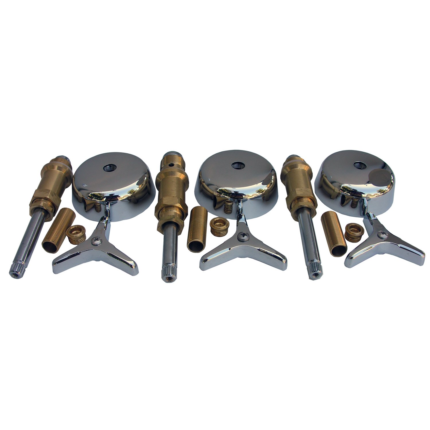

Doing an internet search for tract line instead of trac line I came up with the Lasco version. Tract Line is the correct description.
American Standard rebuild kits are available in Colony, Heritage, Renu, and Tract Line. Both 2 and 3 handle versions are available.
These rebuild kits are always easy to find after you know how to find them!
