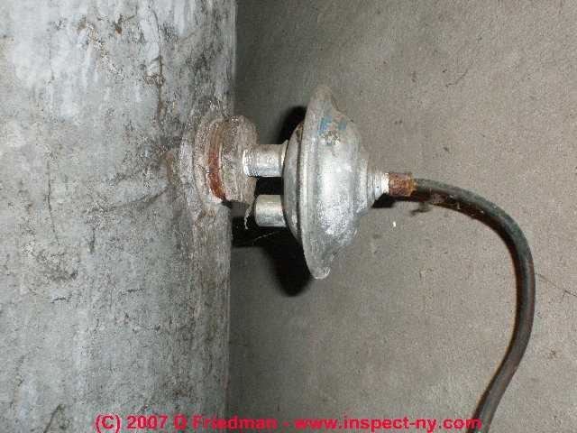

    How do you use an AVC with a submersible pump?

    I'm assuming this is the unit you are referring to:
