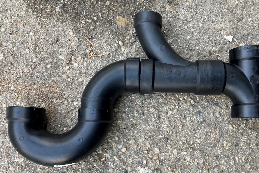

Here's what I have currently.
Current cast iron is 2 inches, the vent is 1.5 inches. I would cut the existing and connect via fernco fittings.
Here's what I'm thinking of doing. Everything new will be 2 inch ABS, including the venting.
Questions:
#1 Can I move the new cleanout from the base of the stack to somewhere higher? This would allow me to move the Double Fixture Tee a little lower so I can lower the height of where the horizontal runs come out, this lowering the P-traps on both sides.
#2 What is the minimum on the horizontal piping sections for the washing machine, with yellow labels A and B on the second photo, I already measured with 4 inch piping sections on both A and B, and assembled with P-trap, combo for vent, and double fixture tee, that's already at least 3 inches too long. Ideally, I'd like to cut the piping to slam the fittings together, similar to this:

The last photo shows a dry vent takeoff via a combo on the washing machine trap arm, which isn't required, so I don't follow the question.
If the trap outlet goes directly into a san-tee which is venting the trap, the minimum trap arm length requires about one pipe diameter (2" for the washing machine) worth of visible pipe between the san-tee hub and the trap outlet hub. (It's a bit under one pipe diameter, but I forget the details, so one pipe diameter is sufficient).
Cheers, Wayne

I should've made myself more clear. Sorry about that. So in this image below, I have A & B marked.
From what I understand, the distance between the P-trap and the vent (Section A) must be twice the distance minimum, so 4 inches as it's 2 inch pipe. I believe.
Is the same required for Section B which is between the vent and stack? So that must be minimum 4 inches too?

The rule is that the trap arm has to be at least 2 pipe diameters in length. The trap arm starts at the trap weir (point at which water first spills out of the trap when you start filling an empty trap) and ends at the edge of the vent opening at the top of the pipe. So with the combo providing the (unnecessary) vent as in your photo, it's the distance between the green lines in the markup below.
There's no length requirement on the section downstream of the vent.
