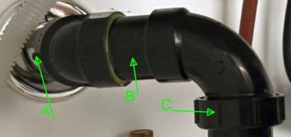

Do you mean the pipe connect the p-trap to the drain inside the wall? There is no adapter to the wall rather some curved short pipe turn that glued together.
41,408
4,996
At A on this picture, I noticed the little protrusion. That gave me hope there was something there that would unscrew. I think you are saying no, the thing at A will not unscrew.
There looks like enough place to put a trap adapter at B, but it would be at an awkward place.
Did you do your snaking by unscrewing C and inserting the snake?
