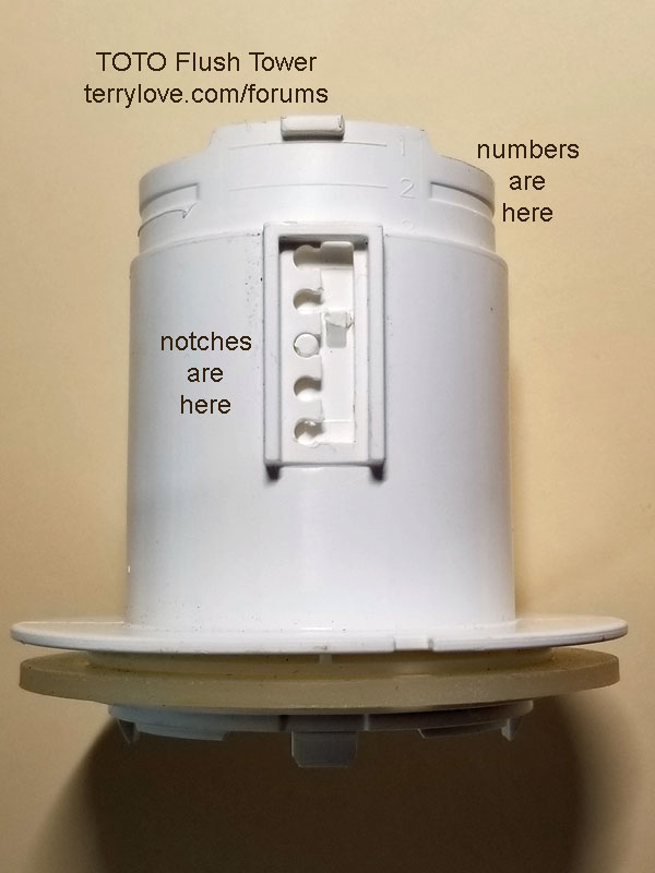

New to forum, but trying to figure out why three newly installed TOTO Drake 1.6 (with tower) are getting plugged up. Push and release the lever and you get a quick forceful flush, but every family member and three guests have plugged one of these toilets. I appears that the TP/waste is getting clogged just as it exits the bowl. If you hold down the lever until waste clears, then no issues. I did some testing with TP balls the size of a softball, I was able to plug the toilet with 4 wads if I just pushed and released. Couldn't plug the toilet if I held down the handle, even with a ridiculous amount of TP in the bowl. It almost appears that the push and release flush is to fast and sucks the waste/TP into the drain all at once, thus plugging it. I'm wondering if the tower version does not flush as well as the older flapper. Also wondering if there are any adjustments that can be made to keep the valve open a little longer with the push and release flush--it doesn't appear much can be adjusted with the tower. Lastly, What should my plumber be checking to see if something is fixable? Venting, wax ring, etc? Just as a comparison, our old toilet was a American standard cadet and it was in the same bathroom for 7 years, never plunged it once.
3,481

Each one has been plugged probably two times each. The water level is just below the pipe in each of them. They appear to function correctly, it's just surprising that they have all been plugged up based on the reviews I read prior to purchasing them.
The valve doesn't stay open long, but that seems like the design. I'm wondering if there is a way for the tower to be adjusted by our plumber so the valve opens a little more.

Hose clip is properly installed and the water level didn't change with additional water into the bowl as you recommended. The chain has a little slack in it, but the valve hits the top of the tower when the lever is pushed. The flush looks pretty similar to the video above. I guess I can have our plumber check the wax ring.

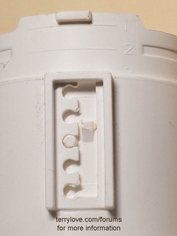

Figured out a solution with a little help from TOTO support. Turns out that the tower valve does have and adjustment: there are notches on one side that allow the sides of the "cup" above the valve to move up or down. Move it down and it holds less water, making it lighter. I pushed the side down to the lowest setting and it increased the time the valve stayed open from 1.4 seconds to 1.8 seconds. Much better flush. I turned off the water and measured how much water one flush used after I made the adjustment. It came to just about 6L, which is the volume the toilet is supposed to flush. Not sure why I wasn't getting a full flush with the factory setting, but this was an easy adjustment. It took a few minutes per toilet, no tools needed other than a small flathead screwdriver to pop the tab out and back in on the side of the tower.
How about a photo or two that could help others address this if it comes up.

I had a very similar problem with a new Eco Drake with a tower valve. About 1 in 3 flushes the bowl wouldn't siphon and the flush would do practically nothing. If I held the flush lever down, everything would be fine and it would siphon, but this was a waste of water and I shouldn't have to instruct guests how to flush our toilet.
Following afg73's instructions, I removed the tower valve and saw there are 5 adjustment levels. I adjusted the tower valve one level (rather than to the other extreme), and now the flush is perfect every time.
Below is a photo. The factory setting on this tower valve was in the top (left-most in photo) hole. I moved it down one click to the second step, as you can see in the photo. I was able to unseat the adjustment just by twisting the valve but needed a flat head screwdriver to reseat it in the second hole by pushing the screwdriver against the nub.

You can adjust the flush tower using a flat blade screwdriver and pushing the tab down to rotate the pin toward the right, and then slide it up or down before rotating it back.
Snap! Why isn't this in the manual?
