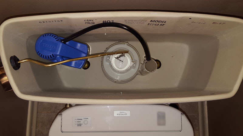

I know this has been asked and answered, but our landlord just replaced a 48yo toilet with the Toto Eco Drake ST743 E#01 and we are both shocked and confused. There is so little water! But mainly, our question has to do with that handle. It takes more effort to push the handle down than on the old toilet. On the old toilet, unless one really held down the handle it sort of let itself go and flipped up by itself. In fact, if one held the handle down too long it could prevent that flapper thing from closing and refilling the tank.
With the Toto, we have to exert more pressure. Do you press the handle down slowly and release it? Or simply press down as quickly as possible and let it go?
Also, it makes this huge "gulping" sound before you hear the water flush. Is that normal?
Midway between those.
With 1.2 gallons flushing, the water has to move pretty quickly. If the bowl clears, the flush is good.
There is a small delay before the tank refill starts
