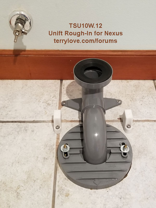

We will not install Nexus nor Aquia ever again because of that moronic design for holding down to the floor.
When they show up in job specs, we tell the customer to change it or find another plumber.
38,903
4,437
Note that the Vespin II is only held in place by the very back of the toilet going down into the Unifit. So it looks like the front of toilet could easily pivot. So why doesn't it slide? It's the caulking! The acrylic caulk provides enough resistance to sliding. Structural caulk!

The Nexus uses an adapter at the floor and anchor blocks for securing the bowl. I've been installing hundreds of Aquia, Nexus and other products that use the adapter over the years, and in my own home at times. Some plumbers get annoyed at things that are outside their comfort zone. I'm not that way. I find it fun and interesting to see the changes and improvements over the years. I had a harder time installing a direct vent water heater that needed an extension kit yesterday. I can install these TOTO products in my sleep I've done so many.

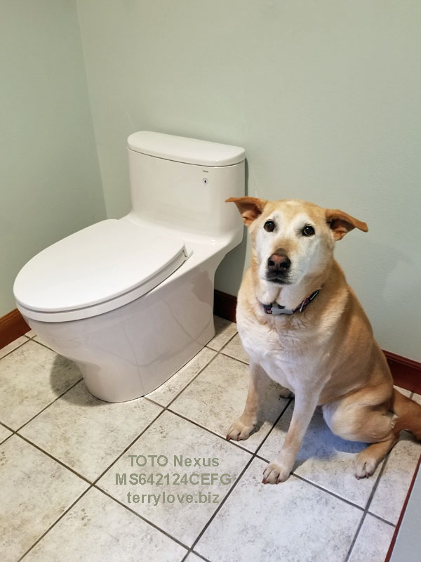

The one-piece Nexus. It also comes at the two-piece.
After installation, I use a PolySeamSeal clear around the bowl. Helps to stick them, and helps to keep liquids from getting under the bowl. You know how boys are.
This guy is a happy camper too.
