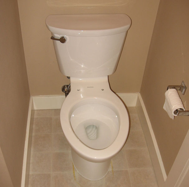

For a standard height bowl in 10", we sometimes sell the American Standard Cadet Pro line with the 10" tank. They come in round or elongated.
Standard height, elongated bowl, Cadet Pro with 10" tank.
