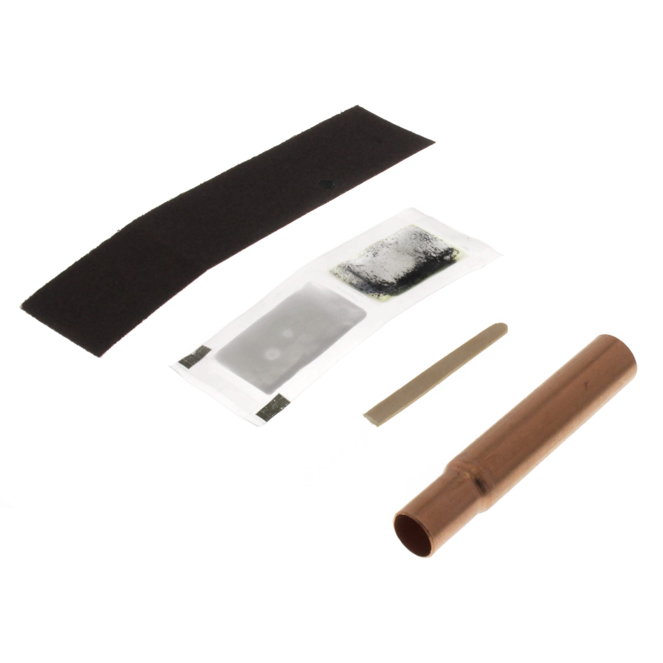

If the in-wall piece of pipe is not completely chewed up, I think something like this would work:
It's a repair kit for tub spouts, can be soldered in, or, more importantly, epoxied: "when soldering cannot be done, copper extension shall be connected to CTS in wall using specially formulated copper to-copper 2-step epoxy".
Sioux Chief part number is 972-3RAKIT. It's cheap, I would give it a shot.

Thank you so much. This is a better way to do it. I saw it says 5/8 inch. will the tub slip on spout work with 5/8?

5/8" is the physical diameter of what we call 1/2" pipe, so all slip on spouts should work. A few retailers for some unknown reason use actual pipe diameter, and in this case the description is just plain wrong, there is no FPT side on this fitting. But that's the right photo and the right part number!
