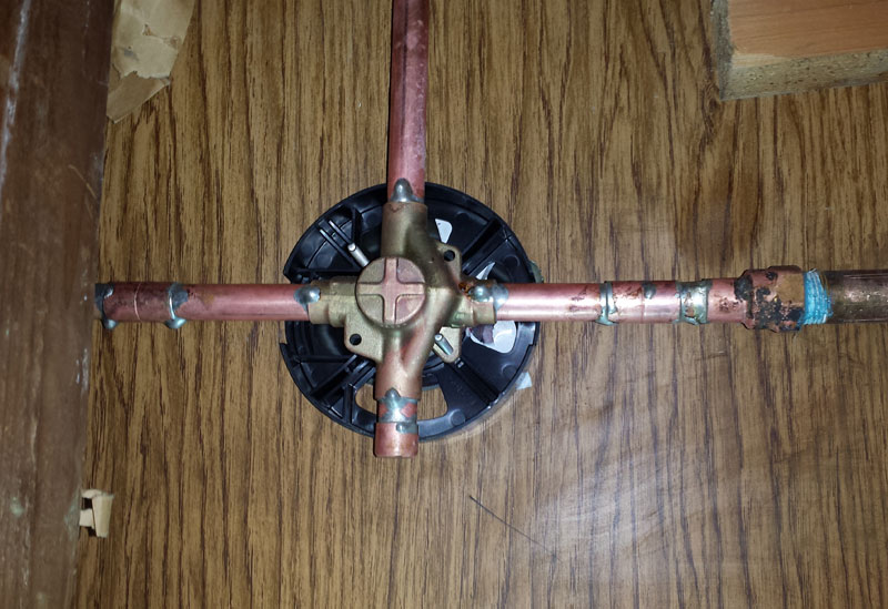

The plaster guard can be installed two ways. Thick wall, or rotated 90 degrees, for thin wall on Moen. 180 degrees on Delta. If that's a fiberglass shower, and the handle sticks out too far, then the plaster guard was not properly oriented when installed. It's fixable if you don't drop the screws, and have some flex in the water pipes. Also, you might could remove the plate and shim the plaster guard/valve deeper into the wall.
photo added by Terry. A Posi-Temp with plaster guard left on for installing on a fiberglass shower stall.

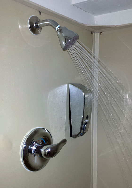

I am having the same problem with a new Moen shower faucet. The handle just sticks out too far from the escutcheon. In addition, the handle is not solid, it wobbles around on the stem and feels very flimsy. I am not a professional, just a simple homemaker having her bath remodeled and I appreciate your patience and help. My contractor took two weeks off to work another job and I do not want to interrupt him while he is on that job. I will talk to him about it when he returns to finish my work. I purchased the Moen Brantford at a high end supply company through my contractor. I called the salesman at the supply company, and he said that is just the way the faucet is and in order to make it closer the contractor would need to go through the wall. I have perused this thread and the only solution I have found is the complex solution posted by John, or have my contractor go through my closet wall to shorten the valve/stem. Also, someone mentioned a part to extend (add on to) the escutcheon, but I cannot locate this and my faucet is chrome. Are there any other solutions? Should I just go back to the plastic, faux crystal faucet knob?...I think my contractor threw it out already! Is there another/different faucet that would make this less obvious? I assume I need to continue with a Moen faucet since the valves are Moen, is this correct? I do not have allegiance to that brand. Please see the accompanying pic. Also, the new hose is going to be returned for either a longer or shorter one as this length interferes with the operation of the handle.
Thank you in advance for your help. I really appreciate it. Carol

Carol,
If the handle wobbles, it may be that the adapter is not screwed on tightly. There may be some movement, but not very much.
I'm sorry that all you people are so bothered by a little bit of tubing showing.
Yes, the only way to fix that, is to worry it to death.
What you have works, and I'm guessing it fitting into a shower or tub stall that is 48" or longer. That 1/2" to 3/4" is gonna ruin it.
I feel sorry for Moen tech support. They do their best to make a faucet that you can't screw up and that's not good enough for some.
There's a good reason why on most valves, the metal handle is not connected directly through metal...the handle can actually become too hot to touch and burn you, depending on the hot inlet temperature. There is nothing 'wrong' with the install. Standing IN the shower, you probably find it looks fine. My recommendation is to always mock it up and decide how YOU want it to look, but if you don't express a firm opinion prior, the plumber just followed the instructions - it works, and is how it was designed. That you don't like it, maybe you should not have bought that valve. It can be modified, but personally, expecting it to happen for free when all factory installation instructions were followed, is expecting a bit, and if challenged, you'd lose in court.
