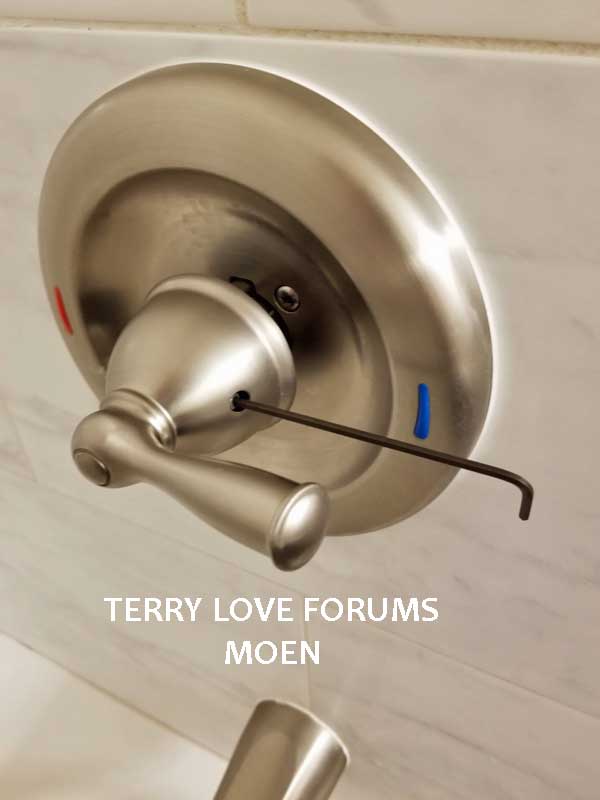

I have lurked on these boards for a while and it has been a lot of help. I just signed up because I have my first question. I am in the middle of remodeling my bathroom. I got a Moen shower/tub faucet kit from Lowes. It is pretty simple. Model 82496BN. Anyway, my plumber begrudgingly (he was not happy with me shopping at Lowes or Home Depot) installed it. The problem now is that the handle sticks about 2 inches from the wall plate (not sure what that piece is called). I have taken enough showers in my life to know that it does not look right. I contacted Moen who informed me that none of their products should look like that when installed properly. My plumber blames it on poor products being sold at Lowes, and the pictures on the box being deceptive. Anyway, does anyone know why this would happen with the handle sticking out that far? Is it something simple that was overlooked during the install, or is my plumber right and everything sold at Home Depot and Lowes is junk? Any help is greatly appreciated. Thanks.

Aesthetically, maybe not, but it is within the limits of the valve. If you couldn't get the plate flat against the wall or there was unfinished metal showing, then it would be out of spec. It would have looked better if the valve was further back, but there is nothing technically wrong with it IMHO.

Those valves, as with most, are made to have variable depth to a degree.
Jim states it well above...as long as the flat trim plate is on the finished surface and the chrome tube covers the area between the trim plate and the handle, it's installed correctly.

If it were installed improperly, the trim plate would not have fit against the wall, and then you would have a reason to gripe and a real problem. As it is, it is a normal installation. your real problem is that Moen makes that "clunky" handle that never looks right no matter how you install the valve.

If this were starting from scrach, with the walls open, you would have had more leeway with setting the valve body a little further back. If your plumber had to work through the 6" diam hole in the fibreglas, or even if he had an access at the back side, he maybe did the best he could to just get the valve in, and did not have options about location.

He might have put it in a little differently in that case. Was he informed what the thickness of the finished wall would be?

OK, we have answered all the questions except the basic one asked in the first post: What's wrong, and is the faucet defective because it was from HD or Lowes.
1) It was just not installed correctly.
2) Moen is Moen, and it is a good brand, and with that or any brand, it does not matter where you got it. HD/Lowes do not stock faucets that stick out too far just because somehow they are cheaper.

According to Moens own specs, they allow 1-1/4" tolerance plus or minus.
If you found someone at Moen that doesn't agree with their engineered specs, then either that one person is wrong, or they need to change the spec sheet.
However, that being said, everything about that valve is working and I've seen many installed that way and in use.

My plumber just replaced an old Delta single handle shower/tub fixture and installed a Moen 82496bn. I chose this Moen because it had a spout that didn't protrude too much and a smaller shower head. The handle sticks out about 3.75 inches+ from the finished wall ( the gap between the handle cover and the wall plate is about 1 1/4 inch. It is not aesthetically pleasing at all, but I have an older house and I'm only willing to do repairs without remodeling or tearing out walls. The plumber and I didn't want to break the tile and open the wall beyond the existing 6 inch diameter opening. The wall tiles are not thick but the mudded wall behind it is about 1 inch thick. Is there any adjustment that can be made to reduce the gap? Thanks to everyone for all the information. Jim's link to the Moen specification website was very helpful as well as Terry's information on Moen's tolerance for installation.
