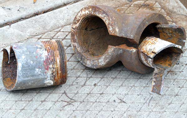

I haven't been able to locate a video showing how to grind off an elbow or tee and save the male threaded pipe.
If you are new at grinding, ALWAYS practice on something else first. You'll get used to how to be safe with it. Never let your first use of a grinder on the repair object.
To grind away an elbow to save male threads on a pipe is easy. Experience tells me to make a cut at the small of the elbow, I wedge a prybar in there, and it loosens away after I widen it, or splits into two. For DIY first timers, you can grind multiple spots, just keep at it until the elbow just loses integrity and eventually succumbs to falling apart.
To grind away a pipe to save the female threads in an elbow or anything else, grind off pipe so that you leave about an inch on it. Then start grinding cuts along the grain of the pipe, and use a chisel to dent the pipe inward, eventually you want to be able to use a Vise-Grip to curl the pipe so that its diameter gets smaller and smaller and eventually it collapses out.
I can do either of the above in about 60 seconds, quicker than it would take for me to fetch a can of PB from my van which I know will not work here.
Parts are inexpensive to replace. Grind out whatever you want to, and replace it with new.
