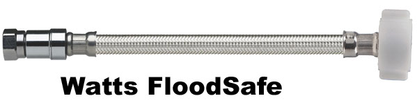

We've been using good quality braides supplies,
Not the Watts Floodsafe though, those are junk.
Glad to hear it's not just me. I tried a set with those checks a year ago and they had just the problem I feared: they were too sensitive. I've also had trouble with the standard Watts braided lines for the washer. One started leaking the first time I removed and reattached it. The old black rubber hoses lasted 18 years and many moves before I decided to replace them... one was beginning to bulge. The Watts lasted less than a year.
I like braided lines for convenience, but the only major plumbing failure I've had came from some damage to one of those during a faucet changeout. It got some twist in the braiding and I should have known better than to trust it, but I was tired of making unanticipated parts runs that day. Blew out that night and I awoke to several thousand gallons of water in the house. Oh, yeah, that was fun... :eek:
