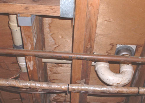

This is the main stack...
Note how it is offset from the foundation wall. Also that it interfered with the joists (all the branchings from the stack are done at same height as the hoists)
Note how there are NO JOISTS underneath either of these bathrooms. The stack continues straight up, and is "in" the wall above it. That wall separates two bathrooms. Both bathrooms are being redone. The one at right will be done now. The one at left will be done later.
(seen branching out left & right of the stack are the connects to the toilets in each bathroom; seen extending "away" from the wall are the pvc to the left bathroom's shower and the right bathroom's sink; seen extending "into" the wall is the pvc for the right bathroom's tub and the left bathroom's sink...the next 2 pictures shows the pvc "into" the wall, and the right bathroom's stack & connects on the ground floor)
I need to replace the subflooring in BOTH bathrooms, but as I said, I need to do them separately. That is why there is a problem with NO JOISTS underneath: it is all one subfloor.
I have a friend who says he can jack support the left bathroom's floor, and, coupled with adding whatever joist support he can add, proceed to subflooring only the right bathroom . Then we'd tile walls & floors and fixturize that one. Once the right bathroom is completed, we'd go back later & redo the left bathroom.
He mentioned it would be a WHOLE LOT EASIER if the branching from the stack were done below the joists. That would mean redoing the stack to lower the branchouts below the joists.
What would you expect a plumber's cost to be to have that stack redone to branch below the joists? $500? 5,000?? Gimme a ballpark for labor & materials.
I'm considering doing it myself. For a virgin pvc DIY'er, am I looking for trouble? How long do you think it'd take?
Finally, what would YOU do? Jack & joist & leave the stack alone, or redo stack and then jack & joist?

I hate to be negative, but I see too many things that would be a no-no in my area. You need to have a local plumber look at it, sorry.

Everything is original plumbing for new construction in 1974, presumably to code. All except the open drain on left of stack (has clear plastic tube inserted in & attached to it) that handles new high efficiency gas furnace just installed. Plumbing inspector signed off on permit for that. Not disagreeing with you that the whole thing is a mess, just don't want to do more than I have to.
I'm assuming not changing the stack and just fixturing in new tub/toilet/sink is an a-ok option. But what about price/time to just drop the branchout from the stack down below the joists?

You need to rip out that whole mess; there's just too much wrong (plumbing AND structural), to bother trying to save anything.

One of the first things we would have to do is get rid of all those horizontal drainage tees..

70s plumbing with Ideal crosses
Its not very pretty, but it still functions fine...
I dont care for mixing grey sch 80 fittings in with the normal stuff
we used to use those double Ideal crosses with side outlets all the time.....
they kept things high and up out of the way...
does anyone see a problem with them????
they are very, very user freindly in a situation like that
I still have bunches of them....and have no problem with
useing them anytime .......
they are the easiest way to vent both toilets and
use the side outlets for either runs to the tubs,
or showers without having to add extra vents..
everything is technically vented into the 3 inch stack.....
everything gets vented well with that kind of fitting.
never had a problem with them
from what I see, the only thing wrong is what has already been stated.....
tees on their sides and backs...
and that is very--- very easy to renovate
Everything appears to be vented and revented very well too....
It all just looks old, because of the wet discolored wood and plywood.....
The PVC is the old GENOVA brand, which turns more mellow yellow over time
but it still should be good for about another 250 years...
If I had to make an estimat e to take out all of that and
re-do it in new pvc all the way out the roof, I still would use that double Ideal
and would charge you a total of about 1500-2000.
but if what you got will last oyu another 25o years ......what more could you ask..
why dont you just make tohse little modifications and then paint it Latex white.???

Those crosses are a drain cleaner's nightmare
And the crap will skip right across to the other side until that toilet is flushed.
Having a toilet pulled on one side of that equation and flush one that has excrement in it........it will end up in the 90 pointing up at you.

Sinkhole...the whole setup is fantastic, in fact you should build a soffit and box it in...don't worry about any of those silly cleanout thingies...they're just there for show...box them in too.
Let's see.....
I see a leaking connection from PVC to Cast Iron
I see a street 45 in the bottom of that cross that looks like a bad solvent weld connection and siliconed instead *shiney with brown residue significant of leaking*
I see a san-tee laying on it's back
I see an unvented 2" standpipe under the flood level rim it serves, first clog in that stack and it's a cross-connection to that vinyl tube that is hanging in it
I see a cross that has 4 connections into it that have no flowing sweeps to the two smaller drainage connections
This, https://terrylove.com/forums/attachment.php?attachmentid=2387 is a leaking connection that the only repair is removal/replacement as there are no removable parts to correct the leaking
I don't know how many types of glue, if it was even glue on a few of those connections and were they properly done and are air and water tight
On top of all of this, this was a patch and go design and you can see visible leakage from either improper workmanship or just plain and simple
faulty plumbing.
