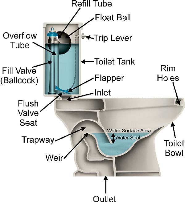

(2) The "normal level" in the bowl isn't necessarily the indent. Here's a cutaway showing what's inside the toilet. The bowl should fill to the point that water is just about to flow over the weir. It can fill no more. Any overfilling just flows over the weir and down the drain. To see what its "normal" or "settled" level is, you overfill the bowl a bit and see where it settles to. You can mark that with a pencil. That's where it should fill to. (One way newer toilets save water is to fill precisely to that point, by matching the percentage of water that is used for refill to the time that the tank takes to refill, so that when the tank shuts off, there's exactly the amount of water in the bowl that there should be, and no more. Older toilets generally overfilled the bowl a bit (or more than a bit) and just let the extra flow over the weir and down the drain.)

Rim was your term. You said "Hold the handle down 1-2 seconds and the water level is about even with the rim." So whatever you used to describe the highest water mark that would stay for a minute is fine with me. If the water was temporarily higher than the weir, it would not stay at that higher level.
An ideal flush will reach that maximum level just as the water shuts off. If the water shuts off with the water an inch lower than that, your fill valve is not doing the required job; adjust if possible, or replace.
