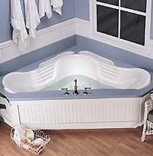

    Hmm. Deck mount faucet could be good. even if you made a little wall upward on the southern part of the deck you could have the faucet coming out of the wall (halfwall-- not a full wall). I hope that makes sense.
    Sort of like this:
    [​IMG]
    But I think you are thinking of something more like this for the faucet:
    [​IMG]
    I wonder if this tub has enough space where it goes in to wrap around that vent in the bulkhead:
    [​IMG]
    I'm guessing that it does not. It's a huge tub though. 72x72 or so. I'm not even sure if it is a drop-in.
    I wonder if it would be possible to find a tub that is designed to have the faucet in that corner so it would allow you to cut that corner out for the bulkhead. I'm guessing the answer is "no".
    The more I think about it, the more I believe it would be best to have a tub deck that is comfortable for sit and swing to get in. Say you are waiting for the water to get to the right temperature and want to sit on the edge and check the water with your hand before getting in. It's easier to do while sitting. Also, with your wife's loss of feeling in her feet, if she is stepping in, she might not be able to feel the bottom of the tub very well and may have more of a chance of slipping/sliding a bit and could end up hurting herself by falling in a sort of splits on the tub deck (I have done this while getting in and out of a tub before- it sucks). With some well-placed grab bars, I think the sitting entry is easier. Plus, you are less likely to bang your shins on the edge of the deck that way-- unless you have a soft sort or rubberized edge to protect your shins.

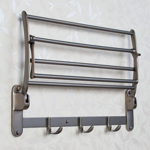

    There are many options for towel bars. I know they actually make shower rods for curtains that have extra bars just for towels. I don't know if they make them long enough for the custom shower though. I wonder if there is a type of towel bar that could go on the outside shower wall. I would hesitate to mount one on the glass. I wonder if there is a folding towel bar that can extend out from the wall when it is needed and then fold back to the wall when its not. For instance, It can be flush against the wall and out of the way when nobody needs a towel. Then it can be folded outward so it sticks out so when a person gets out of the shower, they can just grab a towel and fold the bar back to the wall, dry off, and hang the towel back up or put it in the laundry bin.
    There is a rack that folds up:

    • Near tub - I think fixed or folding racks (thanks for pics) on the wall between toilet and corner unit might work, We saw some wall mounted heated units(!) which looked interesting. Costly toy to run though, and would need a wall plug.
    So that might work - two fixed wallmounted towel racks with hooks, on either side of the make-up unit - heated by tub, not heated by entrance.
