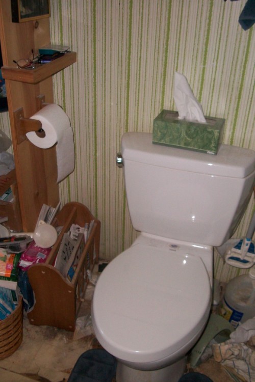

    In my mother's bathroom, my father built shelves on the wall above the toilet and there is a support board coming down that has the toilet paper holder as well as a little mini-shelf to hold pencils, lead refills, nail clippers, reading glasses, etc. The framed thing above the little shelf has artwork made of seashells inside. Please ignore the clutter on the floor. LOL.
