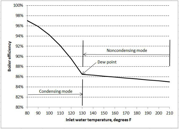

Your return water temp has to be at/near 130F to just hit the very beginning of the condensing threshold- which means in a “standard” system that assumes a 20f temp difference between boiler supply output and return- your supply temp should be around 150F.
If you look at the efficiency curve chart- it indicates that you really want the return water to be closer to the 110F range- which would mean nearer to 130F supply temps.
Using the baseboard BTU chart- you’ll see that at 14’ of baseboard at 120F (split the difference between 130F out and 110F return temps) can only put out 190 BTU x 14’ = 2,660 BTU’s. There is no boiler that can fire down that low….
If you combine the 14’ basement and 36’ second floor zones into one 50’ zone (which would perfectly match your 50’ first floor zone) you can then use 9,500 BTU’s. With that in mind- you could use a high turndown mod-con like the HTP UFT-80W (or it’s clone- Westinghouse WBRUNG080W), with it’s 10:1 turndown ratio it can modulate down to 8K BTU at it’s lowest fire rate.

Ignoring the 14' zone for now- Your second shortest zone has 36' of fin-tube, to be at 94% efficiency you need to have 100F return water. With AWT of 110F that 36' of fin tube can only radiate 5,760 BTU's. The smallest Viessmann from the above link can only modulate down to 12K BTU's. How would it not short cycle on that zone that's only putting out 5,760 BTU's?
To prevent short cycling on the 36' zone at 12K BTU minimum boiler output you'd have to supply 150F water, 140F AWT and hope for 130F return- but if you look at the chart in an earlier post- 130F return water is just at the cusp of condensing mode at 86% efficiency.
With an 8K BTU minimum boiler output your supply would be slightly over 130F with a return near 120F which is in condensing mode and very near the 8K min output of the boiler.
