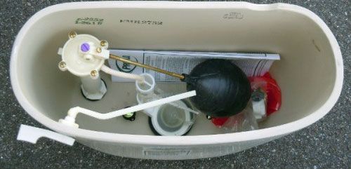

Leaking toilet after 2 flapper changes

It's hard to know from your description. Forgive if I'm being redundant, but I would flush it, let it fill, turn off the water at the wall valve. Let it sit. See how low it goes. You say it drains halfway. If it drains halfway every single time to the same spot, I would check that overflow riser for a crack. Pinch it a little at the top and make sure it doesn't deform.
I would start with trying to fix it, though.
Thanks very much. At the moment I removed the Korky flapper since the problem did not go away. Previously I installed the Korky Easyfix, with new seat, but the problem persists. The water level falls to different levels below the halfway mark. I put dye in and noted the water does get to the bowl. I suspect the tank seal since black ink comes off when I touch it and was thinking about trying this next,
https://secure.lockeplumbing.com/detail.asp?c=Toilet Parts&s=Briggs&s2=&sku=BRI-5143&r1=WHE-USS25C&r2=GRU-595916&r3=FEI-NL9-LED
Would it be just as easy to replace the tank? It is a Briggs 4930. Not sure where to find one. It was installed in 1989.

I am not a pro, but it looks like that chain may be able to keep the flapper open, when the links catch on each other.
I hate when that happens.
Cutting off the un-used links, may help. Then they are less lucky to get caught on the others.
Good Luck.

No need to buy a new tank since the porcelain seems fine. Next step is to change the flush valve. If porcelain isn't cracked on the tank, changing the flush valve will assuredly solve the problem, since the water is flowing through the flush valve into the bowl. This is a good one that I have installed in several toilets: http://korky.com/FlushValveKit4030PK.html Available at Lowe's and other fine retailers. http://www.lowes.com/pd_125469-868-...e&pl=1&currentURL=?Ntt=flush+valve&facetInfo= Here are the instructions so you can see what's involved: http://korky.com/PDF/4030.pdf If you're feeling adventurous and want to install a new fill valve at the same time, this Korky kit adds a fill valve: http://korky.com/FlushValveRepairKit4010PK.html Or you can just do that at a subsequent time, as it is a very simple job for which you don't need to pull the tank.
If you are nitpicky as I am, I would also go ahead and use better tank-to-bowl bolts than Korky is going to give you. Specifically, I would double-nut the installation. Meaning, you get a set of bolts that has two washers, nuts and rubber washers per bolt. Korky used to do this until handi-hacks kept screwing up the install or tossing the extra hardware because they didn't bother to read the instructions which were crystal-clear. So now they only give you one nut, metal washer and rubber washer per bolt. Something like this will keep your tank in place for another 30 years or more, although you don't need one this expensive. http://kscdirect.com/item/SIO+490-10500/SIOUX+CHIEF+MANUFACTURING_BOLT+DELUXE+TANK+BOLT+SET%0A But you get the idea. The order is: bolt head and rubber washer inside tank, metal washer and nut outside tank, THEN under the bowl, you use the rubber washer, metal washer and nut to hold the tank in place. If you have or can borrow a big set of channel locks, it will make removing the old flush valve nut easier, and make it easier to snug up the new one. When you reattach the tank, tighten down little by little, side to side, until you have the tank just about touching porcelain. No need for it to actually touch, indeed if it does you can crack it, but the thickness of say 3 sheets of paper is fine. That will give you a nice stable tank. Come back if you have any more questions.

Old post but same problem , Briggs 4430 toilet (marked inside toilet tank) the flapper rubber chain broke off at top of flapper. Not thinking of looking on here and read up , I went to the local Ace hardware store and bought a universal flapper. Installed it and flushed a couple times .Now have a trickle of water inside bowl WTH ?
Turned the water off , drained tank , lifted up new flapper felt the base where the flapper seats , smooth nothing. Googled Briggs flapper and out came all the problems , needs to be a Briggs flapper. I couldn't find one in a search but found that Korky has one that fits the Briggs . I order it No. 65BP. Same thing tricckle of water inside bowl . I get on here and found this thread read it all the way through. Knowing its the flapper and not something else I tried korky.com/FlushValveRepairKit4010PK.html , but still did the same thing. Finally went with the Fluidmaster repair Kit and replaced the flush valve assembly etc.
Works great now !

Opening an old thread here. I have a similar problem; I have replaced the flapper before but the toilet still leaks, red dye in the bowl with refilling tank. This time I replaced all the parts instead of just the flapper. All new Korky parts, top to bottom; tank to bowl seal, washer and nut, new fill valve, flush valve, flapper, handle and lever .. the works. The refill tube is level with the top of the flush valve, the chain sits well and is not tangling, there are no leaks on the floor or under the tank anywhere.
I followed advice in previous posts and checked the tank, the edges are all smooth. Is this simply a matter of the finger tight nut not being tight enough? Should I take a wrench to it, lightly??
I would appreciate any advice, before buying a completely new toilet. Thank you.

If you are talking about the big plastic nut, I don't know how tight to tighten it. Some silicone grease on the sealing surfaces at the tank would not hurt.
For the two metal nuts need a wrench, and I expect you will make many turns beyond finger tight.. You should tighten evenly until 3 points of contact almost touch. You should be able to put a piece of paper between the contact points if you press the tank away from the contact point, but maybe not a business card.
I can't tell from the photo. Is there some slack in the chain.
The large nut needs pliers.
And finger tight on the fill valve depends on how strong you're feeling. I often can tighten things way beyond what the homeowner can with my fingers.

Thank you both for your replies. I removed the tank and retightened the large nut, reseated the tank, leveling and tightening it as well. An hour later and the water in the bowl is still clear. I'll wait until morning before deciding to turn on the water and leave it on, but it does look promising. I really appreciate the advice and hopefully this is finally fixed.

Right, so ... did all this and what Terry recommended as well and as of last Thursday I thought I had it fixed but yesterday I thought the tank looked a bit lower than the previous day (even though I didn't hear any refill water running) so turned off the water supply this morning and went to work and sure enough the tank was empty when I got home.

Did the water level fall all of the way to the bottom of the tank, or did the water stop dropping at the level of the seat?

Water level drops to level with the flapper but not below it. Red dye in the tank, once again shows up in the bowl.

I *think* have finally figured out my problem. I have no idea what was wrong with the last flapper but at least with this new one.
I took it apart again and following someone else's suggested I added a bit of weight to the flapper; in my case I put a few coins inside the rubber cone.
In doing that I had a good look at the actual flapper and how it was working.
I noticed that the flapper in my other toilet that works just fine has rigid plastic sides. This one however has soft rubber sides. I *think* they are catching on the side of the tube and it causes them to flex, which then creates a small gap at the rim of the flap.
See photos. Not tight is when it's not rubbing and the subsequent no gap. The when it's tight to the pipe you can see the flex in the side and the subsequent gap.
So far, this is the only thing I can see that might be causing the leak.
Any thoughts on this?

The refill tube is to far down into the overflow tube causing the water in the tank to siphon. The refill must be above the water level in the tank.
