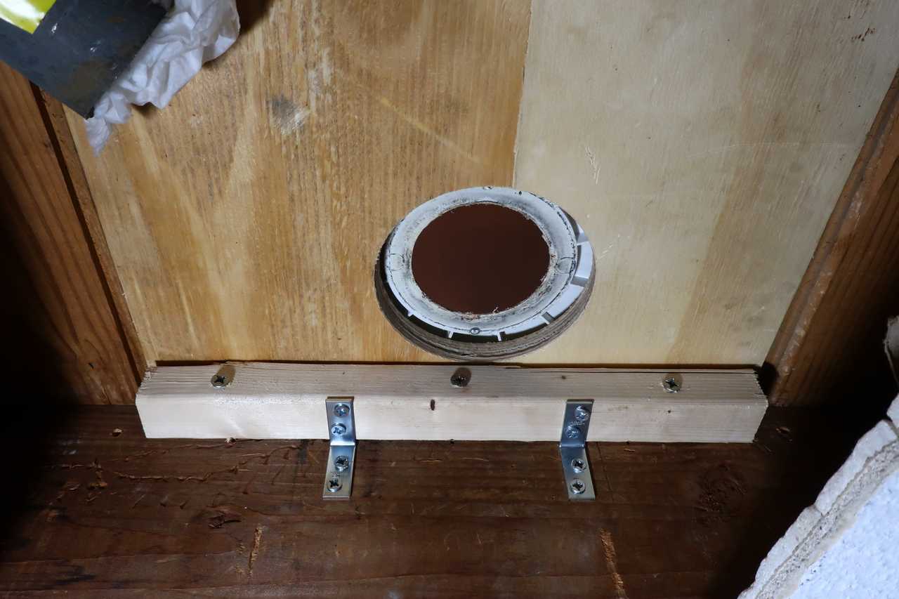

I have a fiberglass shower on a second floor that has sprung a leak - see photos below. What do I need to do to correct this problem?
The lock-ring that is visible from the top of the shower reads:
Caspers Industries Oakland CA
No. 101-PS
ABS IAMPO
Use glue only. Warning: Do not use oil base sealant or overheat caulking material or overtighten lock nut. May cause drain to break or destroy.
I did a search, and it looks like that drain is now made by Oatey.
If a repair is possible, how do I proceed? I am handy, but have not done a shower drain before. The tub drains I have done were pretty straightforward, where as this one with the glued on lock-ring has me wondering how you compress the gaskets to prevent leakage.
Any guidance would be appreciated.

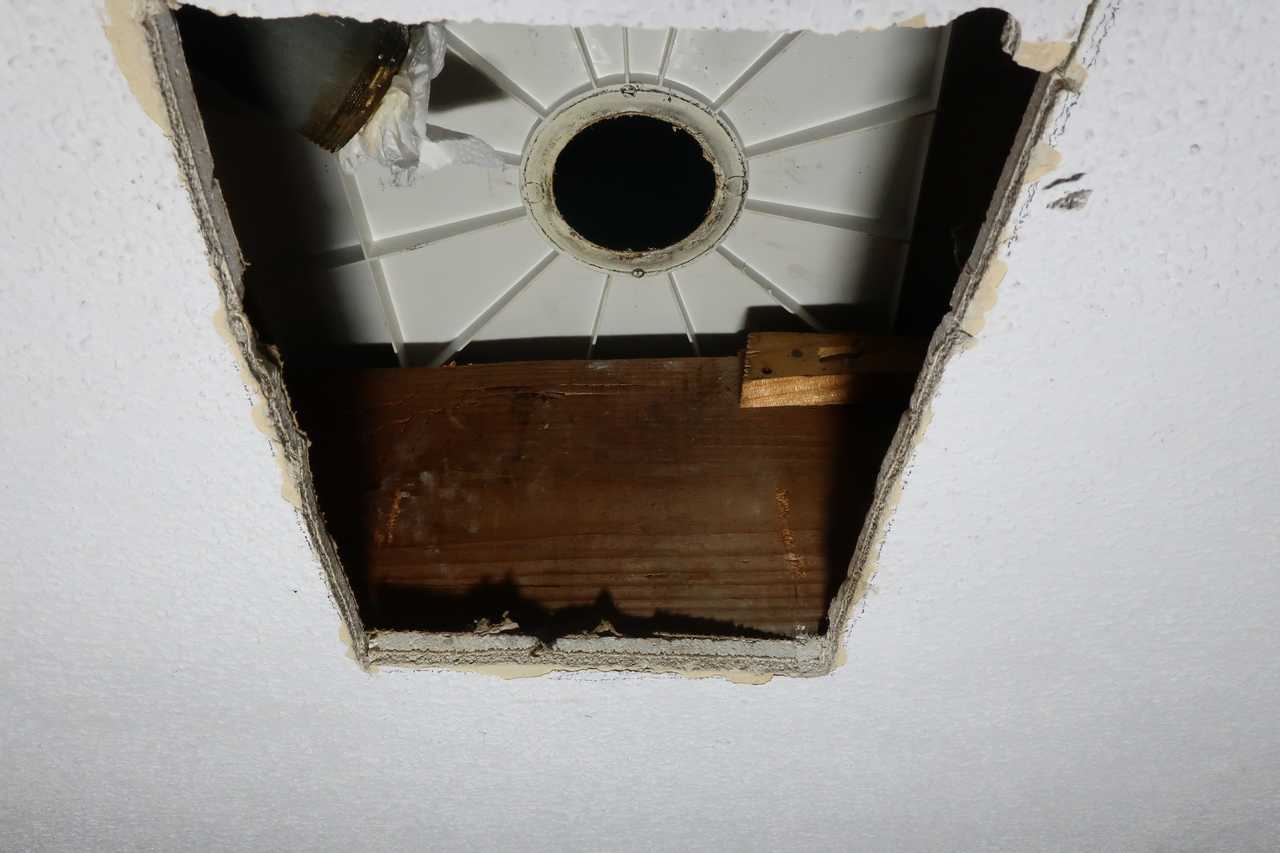

Anyone have any ideas on the best way to proceed? Should I open up the ceiling below the drain and replace the metal trap with PVC?
I like using the Jack Rabbit drains as replacements.
Installing a new p-trap at this time will make the job easier. I also have been using Silicone instead of putty on these.

KC27
36
9
Milwaukee
Thanks for the replies. A previous owner of the house the shower installed. Whomever did the installation left a 9" x 14" section of the shower pan unsupported, so the pan always flexed a bit - we just thought flexing was normal. All was well until the lock nut on the drain cracked, causing the shower drain seal to fail.
Some of the shower pan is installed over flooring. To eliminate the flexing, I was going to support 9" x 14" section that does not have any flooring beneath it with 3/4" plywood attached to the joists. Does this seem like a reasonable solution in this situation? Photo below shows the unsupported portion of the shower pan.

If you are not going to pull the shower to fix it, any kind of blocking to support the pan from below would be better than none.

I installed 3/4" plywood and that eliminated the flexing of the pan. Are drains a wear item that are eventually going to fail? If so is there any difference in length of service between a brass drain and a plastic one? If I go with brass, I will use the JackRabbit by Sioux Chief because this is a tight spot in which to tighten a locknut. The plastic drain that I am considering is the WingTite drain, because it installs from the top, also eliminating the locknut tightening problem, plus eliminating the need to open the ceiling if the drain would fail again.
