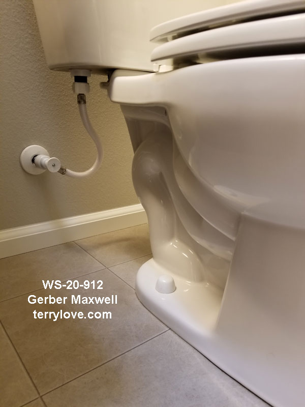

The Gerber Maxwell WS-20-912 toilet with pictures. It looks to have a 3" flush valve and a trapway that around 2".
I found this in a new home provided as their builder grade toilet.
WS-20-912
Here is the standard 12" rough.
I haven't seen this fill valve before, and the flapper is clear. All new.

Gerber /Crane are great as we installed thousands of them . NOT a single call back
Point of information in case anyone is in NYC
I was called as an expert witness for a leak in a Park ave apartment over a doctors office
I was able to prove in court the installer of the supply to the tank did it contrary to NYC plumbing code as they used the same type of connection Terry is showing above
How I won the case was quoting from the code about potable water supply

Because they used plastic with a plastic nut which is not approved the doctors was able to prove negligence on the part of the building management and the installer and the apartment owner

Those chromed copper tubes are really hard to work with in my very limited experience. How about correlated copper or stainless steel supply tubes? Would those be permitted in NYC?

If you think "those chromed copper tubes" are hard to work with WOW
I still like using 3/8 CP Brass nipples but then again I charge accordingly and the brass nipples last for decades and the great part about using schedule 40 pipe is when the fill valves have to be replaced they will fit right on the existing nipple
The corrugated tubing I would not use, bad enough that the "speedys" are allowed
I tried to reuse the tubes when I ran PEX to new stop valves on my lavatory. Way too stiff.
Thinking about it, maybe had I removed the ferrule and put on a new one, I could have slid the open end of the tube deeper into the 3/8 compression part of the valve, screwed on the screw-on part up top, and then tightened the nut onto the new ferrule. I was trying to bend the tubes to insert.

The tubing becomes work hardened once bent, and can be difficult (not impossible) to rebend at a later time. With a proper tubing bender, it's fairly easy.
3,461
A solid riser fits in the nut and ferrule first and then lastly connects to the toilet valve or lav connections.
When tightening, the faucet and toilet connection gets the wrench first, and when that is tight, then the nut at the stop is tightened.
Soft copper get stiffer each time it's bent. Normally it's just a one time use deal.
