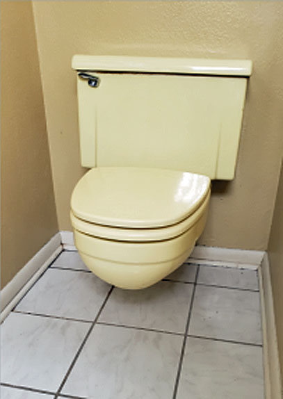

I currently have a 1960 vintage American Standard Norwall toilet in Manchu YELLOW. That wonderful color will not even come close to working in the new bathroom renovation. I'm looking at a white American Standard Glenwall as a more modern replacement. Does anyone know if the Glenwall bolt configuration will match up with the old Norwall?

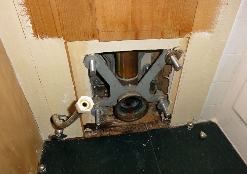

If the bolt layout works out, the other stumbling blocks are:
length of the threaded studs
difficulty or impossibility of adjusting the drain flange
One could get lucky but it is often a better choice to replumb either with a replacement, modern carrier, or convert to alternates either back to conventional drain in floor or up built in frame tank in wall type.
The Norwal has the standard wall hung specs. I've replaced dozens over the years with a variety of wall hung replacements.
For someone like me that has done them, it's an easy job.

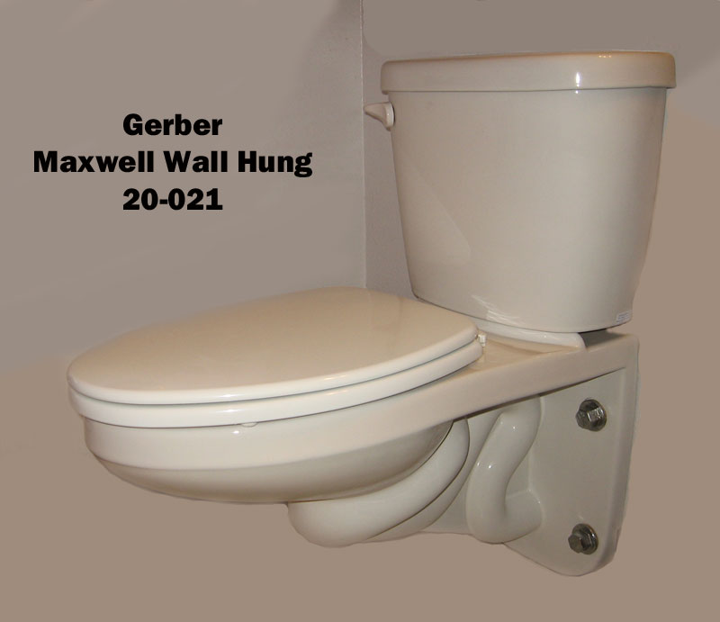

The Gerber Maxwell
You do have standard measurements with the Norwall, which will fit anything new.

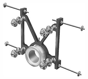

Sometimes it's this one bolted to two studs on either side.
My mother had a Norwall, but at least hers was white. I replace it with a Maxwell for the added height.

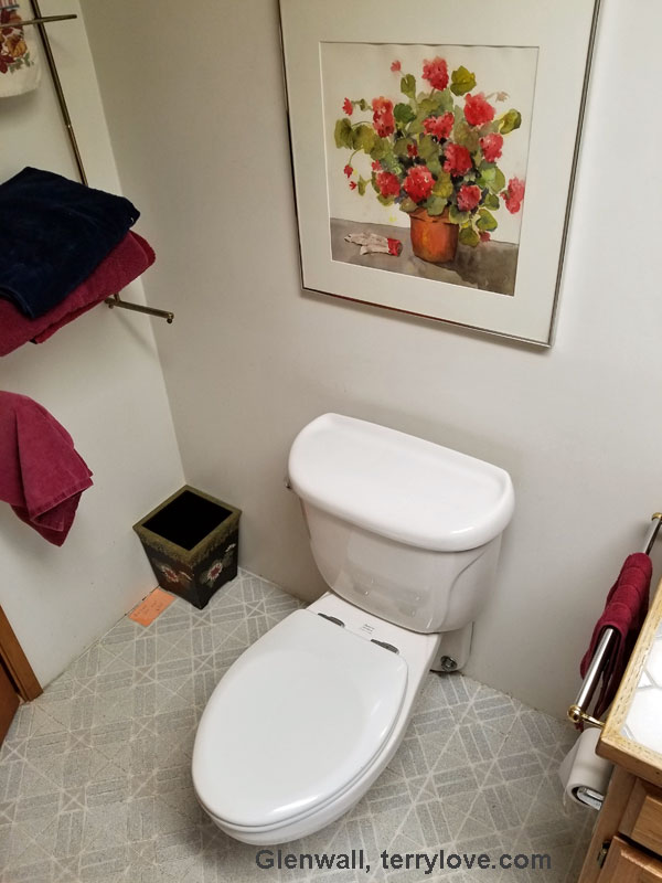

Later replaced with the pressure assist Glenwall.

Thanks for the excellent feedback guys! I definitely have the 7 1/2" by 9" stud configuration. Terry......when installing the Glenwall or Maxwell from the Norwall, have you ever had any issues with the stud length being too short? If so, I was wondering if a stud extension, such as this, would work.
The bolts from the carrier are long enough most of the time. With the Gerber Maxwell I have used these a time or two.
index.php
When the bolts have been too long, I sometimes double up the 5/8" washers if I'm reusing the capped nuts, or pick up some 5/8" replacement nuts that allow the bolt to thread past.
