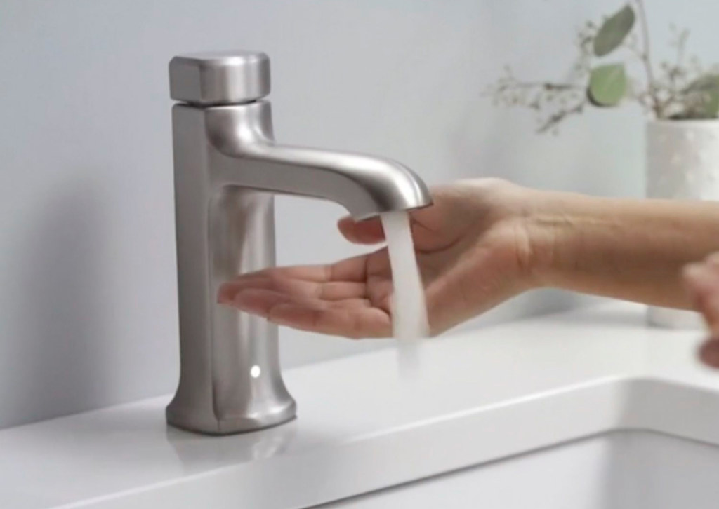

I think I found the culprit(s).
It’s these Kohler touchless faucets. I have 4 of them !!
When you put them on full cold or hot no cross leak.
Leave it on warm position and they are direct hot to cold connection WHEN OFF.
Is that normal for something like this?
I tested one by removing cold side. Turned on the hot water shutoff and it gushed out the cold side from faucet only in the warm position.
Makes some sense.
So anytime someone uses a toilet or does a cold water wash, hot water is flowing backwards through all the pipes.
My wife insisted laundry was getting hot water even though she set it to cold. I triple checked it.
Do they make screw on check valves I can add between shutoff and hose to faucet?

Yep thats what I was talking about. There oughta be a law ? LOL contact kohler theyll give you part to fix free assuming you are the owner.
I cant tell you how much hot water is used you gotta be kidding. you arent using water its only heat you are using

Right. It’s heat I’m losing.
Illegal, I mean as in it should be against code.
Yeah, Kohler might send part after 4 hrs on the phone after finding someone that speaks English with an IQ above a door mat that understands.
I saved myself the headache and ordered 8 check valves.
I put all the faucets on extreme hot or cold (no mix) until they arrive.

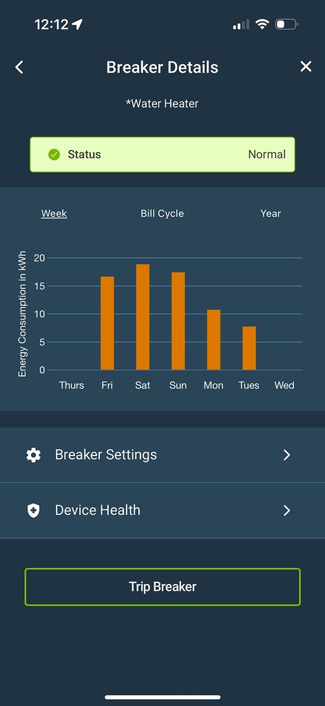

Although it’s a small sample we had more usage than average today. But it shows less than half. So far it looks like it might be on the order of $40 /month
Every washing and every flush was using ~50% hot water.
Running the hose washing the car.
I had 4 potentially bypassing all in parallel.
I’ll check the whole house for cross leaks after I put these checkvalves in.
Sunday Monday was when I was shutting 2nd floor off.
