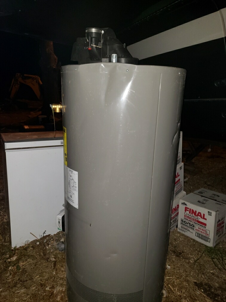

Is this water heater likely safe and functional despite the external damage? I have a chance to purchase this extremely discounted unit, which would replace a 50gal gas Rheem from '94.
This is the unit https://www.menards.com/main/plumbi...spve2-36/p-1444452201895-c-1541513694149.htm?
Edit: I'm able to 'make sure it works' before committing, but would rather not risk it if the damage is in a bad spot for the tank.

That WH should be in good shape regarding that dent. Good deal, I would think.

The 26 year old Rheem is still working just fine too! I wasn't in the market for one but a buddy purchased this and it won't fit his closet. It was still wrapped in the original plastic when he got it, including the dent.

Personally I would not use it. It's expensive to install a water heater and can do damage if it leaks. That said, if you're doing the install yourself, and it's in a place where it won't cause damage if it leaks, this could be your chance to save a few bucks.

As a contractor, I would not install it.
Normally the tanks inside is protected by vitreous glass or plastic layer bonded to the inside protecting the steel shell.
Do you feel lucky that the inside did not sustain any damage to the glass or plastic layer?
If you do decide to take a chance take pictures and also ask if it is covered by the full warranty.

This is exactly what I'd be concerned about.
41,388
4,991
If the glass coating is cracked tank will rust out prematurely. Price 25% of a new one I'd take the gamble.
Isn't there a fair amount of insulation between the outer and inner?

I expected some opinions from both sides, and to be honest I suppose it is anyone's guess unless the unit were to be opened up and inspected. The basement isn't finished yet, but should be within 5 years with any luck and we basically use the basement now despite it not being 'finished'.. I'm still torn on what to do.

For years I've been installing dented WHs, if I felt safe installing them. I installed one last week.
Mind you, around here, most WHs are either in garages or WH metal sheds located outside the house - so the risk of damage from a leak is minimal.
Luckily, I never had a failure.
They used to discount them at 50% off, then 20% off, and now they ship them to outlets which sell scratch and dent appliances.
The nearest one is about 65 miles, too far to drive for a 20% discount.

If the inside is damaged it may take over a year to show up
In most cases the tank integrity is not compromised but as a contractor I cannot sell damaged appliances /fixtures etc as it takes away credibility

Sylvan, the OP is asking for his/her personal use - trying to save some gelt - so why not.
When I replace a WH in one of my rentals, a dented one will do.
When I install a WH for a client, only one with factory box, so the customer can see it, will do.

It's tempting too because its around an 80% discount.. There is a floor drain not 5 feet from the water heater's location, but I'd imagine there would still be quite the mess if the WH were to fail..

About the 80% off...go for it or you'll say: I should have, could have and ought to.
