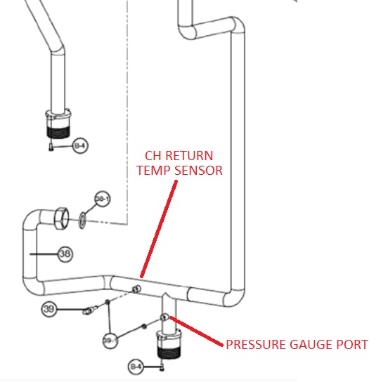

I see other forums talking about the UFT-80w CH RTN TEMP SENSOR and SYSTEM PRESSURE SENSOR installed wrong? Is it wrong or will they work in either location?

IIRC those were isolated incidences, but in any case- you can verify your sensor and pressure port locations with the illustration below...

If you were only using the bottom return it wouldn't matter... but since you're using top and bottom returns- you should swap locations as indicated by the factory diagram.
I'd let HTP know so they can straighten this production issue out.
Below is from one of their sales brochures for the UFT- with the temp sensor and pressure line in the correct positions...

If you pm me with your email address I'll send you their brochure (which you can forward to HTP) from 2016 which clearly shows the temp sensor in the horizontal return run and the pressure tap in the vertical return run.
You can also show them the parts page from the current install manual that also shows the the temp sensor in the horizontal return run and the pressure tap in the vertical line.
Logic question.... with the temp sensor in the vertical line, how will it measure the temperature of the return water if it's coming from the top boiler return port? That's why the temp sensor is supposed to be in the horizontal line downstream of all incoming connections... so it gets return water no matter if it's coming from the top or bottom boiler return connection.

Sounds like a plan, gonna order thr gaskets. Just makes sense to swap them around so the CH Loop Sensor reads all RTN water?

^ Well, that's how it was designed :D

Also I already swapped out the sensors and purged system of air all is good so far.
