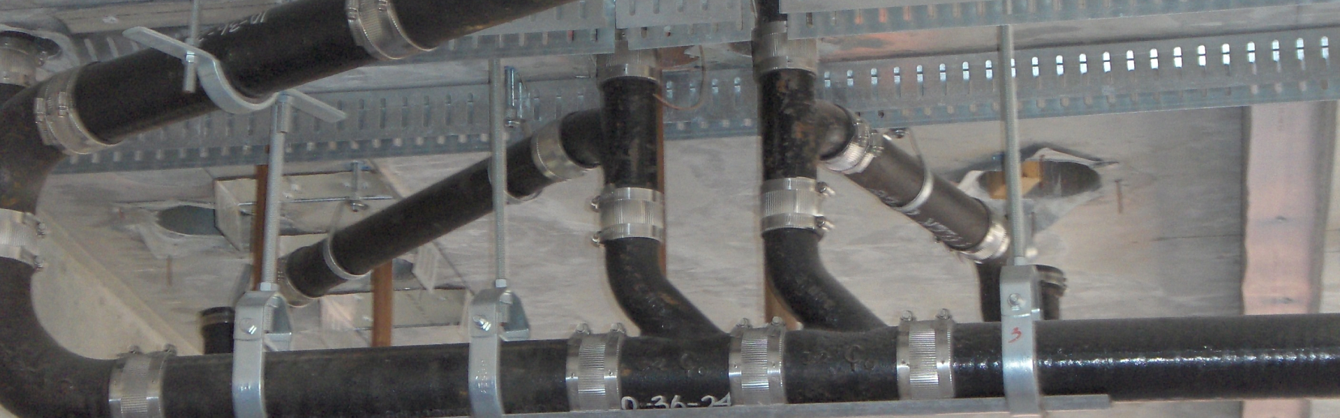

James Henry
1,655
423
83
Billings, Montana.

The page your referenced seems to disallow the 3 connections in the same place:
You raise a very good question to which the answer is not clear to me. I'm somewhat inclined to say that with the 3 horizontal inlet san-tee, there is no wet vent, as vertically the pipe above the inlets is the dry vent, and below the inlets is the drain.
That does raise the question of whether the original configuration proposed would be considered 3 individually vented fixtures, or not. If not, then it would not be allowed as a common vent, since that is restricted to 2 fixtures. However, that whole discussion is moot:
If the lav is only one stud bay away, drill the stud and connect the lav trap arm to be individually vented by the stack. Then the shower and WC can be wet vented below. You can stack a 2" san-tee for the shower above a 3" san-tee or wye for the WC. Or you could use a 3" san-tee with 2" side inlet and bring both the shower and the WC in at the same elevation. [I.e. the two options in the diagram from James.]
Cheers, Wayne

Thanks a lot for the help with this. After reviewing all of this and writing some things out it seems to make a lot of sense to do it like the second drawing in James' picture.
