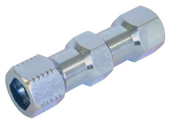

Savoy tub socket, valve stem nut is not hexagon
tseiple
Baltimore
I am helping a neighbor with a leaky hot water shower faucet in a house that dates from the late-50s early 60s.
The stem has a 15-point broach. But the main nut (not the packing nut) is round with two opposing flat areas, instead of hexagon, so a cowbell would not fit.
Can't quite get pliers on it without chipping some tile. So before I work hard to remove it, I want to determine if replacement parts are available for this odd stem, especially since its not my house.
Any insights are welcome. Thanks all,

Google "Savoy tub socket" You will need to reinstall the packing nut to ensure the bonnet keeps it's shape.
