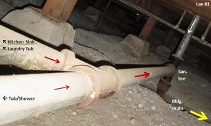

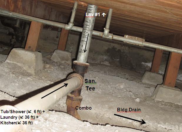

Three drains (kitchen, laundry and tub/shower) block in unison every couple of years and the clog has always been cleared at the downstream sanitary tee shown below.
It has been suggested I replace this abrupt fitting by a long sweep combo.
This seems to make sense because I can’t see any need to admit vent air upstream into the lateral drains at this location since all three upstream fixtures have their individual sanitary tees, vents and traps. I also thought san tees were only effective for short laterals or low volume waste flows.
I would appreciate comments explaining any reason not to go ahead with the change.
I’d also like to know why a sanitary tee might have been required at this location in the first place. E.g. was it a toss up between a sanitary tee and a combo in the original code and why?
BTW this is a 58 y.o. single story two bath California tract home with a basic cast iron / galvanized DWV. The building sewer out to the street may be clay or cast iron.
Thanks.
(The two views are at right angles to each other):

I can't see where changing that fitting would help, except it would let you see how gunked up that horizontal run is. I am quite sure that is where the problem is.

  • I just realized from the photos that the outlet of the sanitary tee appears to be a spigot connected directly to the hub of the combo underneath. So maybe the long sweeps available to the tract plumbers would not fit??
  • Is there a style of long sweep combo fitting that would fit?

There is no need to change the san tee. Your setup is normal and a bazillion of them are working across the nation.

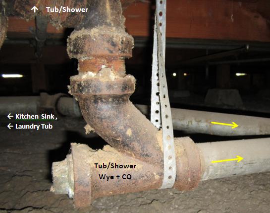

I will still have a plumber replace the 2” galvanized lateral drain pipes which are all in the crawlspace. These service the KS, LT and tub / shower.
  • Is the best plan to simply cut the GI pipes just after each of the three Wye clean outs and just before that san tee, and then swap in the new pipes using banded rubber couplings?
  • Should the new pipes (and intermediate Wye and bend fittings) be ABS, PVC, or, do I stay with Galv & cast iron?
[The goal is to stay in the house for 20 more years "DWV-service-free" after which it will probably become a tear-down.]

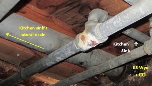

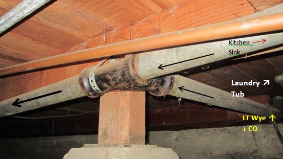

Thanks. These photos start at the kitchen and progress down to the san tee:

That looks exactly like my Santa Clara house (other than a slightly different grouping of drains) just up the road from you. About once a year, we (and many of the neighbours) get the same clog like yours. The short-term fix takes about 10 minutes with a small consumer-grade snake. One neighbour claims he had the lateral drain properly "snaked out" (by a competent plumber, not some ***-drain-*** company) to remove the massive amounts of rust, and has been clog-free for about 6 years now.
Cacher_Chick
Test, Don't Guess!
5,461
214
63
The iron/galvanized horizonal run is very likely full of scale from corrosion, which creates a restricted/slow drain, with the solids building up until the priblem becomes obvious. If the line were being rodded with a mechanical rodding machine and a properly sized head, most of the scale could be flushed out of the line and the drain would be likely to work fine for several years. Replacing the primary horizontal run with PVC will also be an effective way to get rid of the bulk of the problem. It would be quick and easy to cut out and replace just that and it might be fixed for a long time to come.

Re. switching the san tee to a long sweep combo, I mentioned above there might be a clearance issue since the height of the incoming lateral is already established by the overall system design. It looks like the current san tee has a spigot outlet that plugs directly into the hub of the combo underneath and perhaps that's why they used it i.e. the inlet to the tract builder's san tee was at precisely the correct height to match the incoming lateral whereas a long sweep combo would be too high to line up. I didn't get any feedback on this sub-topic and am still curious what the forum thinks.
