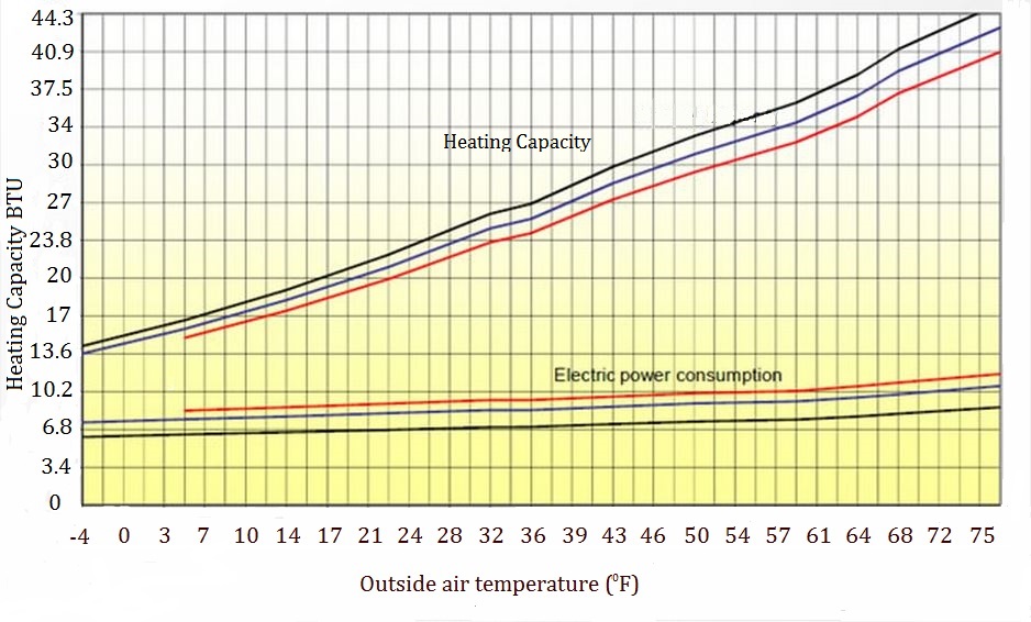

A Fujitsu 15RLS3H can put out about 15,000 BTU/hr @ -15F, and quite a bit more than that at 0F or +5F. A -12RLS3H can deliver 12,000 BTU/hr @ -15F and about 17,000 BTU/hr @ 0F. A mini-ducted Fujitsu 18RLFCD puts out about 20K @ 0F, if there's a basement or crawlspace for running mini-ducts to doored off rooms. Mitsubishi's FH-series mini-splits are somewhat lower in heating capacity per ton than Fujitsu's cold climate mini-splits, but the FH18NA wall unit type puts out about 20K @ 0F too.

The Daikin Altherma air-to-water heat pump is about as efficient as air-delivery mini-splits given sufficiently low water temp requirements, but it's expensive and doesn't have sufficient capacity at your (apparent) water temp needs. If it was a radiant slab that only needed 90F water on design day it would be worth pursuing, but you're talking ~140F water, which won't cut it.
The efficiency of the Altherma is higher than a cheap chiller because like air-coil mini splits, it modulates with load, and at part load the efficiencies of the "oversized" heat exchangers is much better, and the power of the pumps & blowers much lower per BTU delivered. A 1-speed heat air source pump uses the same power whenever it's running, so it's efficiency & capacity dependency is fixed, depending only on the air temp and output water/air temp, whereas modulating systems' efficiency also varies with load.
A mini-split running at max speed at 10F isn't going to pull a coefficient of performance (COP )better than 2, often more like 1.5, but if it's loping along at 1/3 power at that temp it can be bumping on a COP of 3, even at 10F. At 40F running at minimum modulation they can beat a COP of 4 or sometimes 5 (depending on defrost cycle losses.) Optimally sized to the load a best-in-class cold climate mini-split will deliver a seasonal average COP between 3.0-3.5 in your climate, even though when it's below 0F it won't be doing better than ~2, even when modulating.
This bit of bench testing is now bit dated, 1-2 generations back from the current state of the art, but it's instructive for seeing how much difference modulating can make. The clearest picture is figure 5, p10 (p18 in pdf pagination), where the COPs of the 12RLS2 are tested at 3 different speeds at a number of outdoor temperature conditions. At 35F outdoor temp a the lowest compressor & blower speed the efficiency is a COP of about 5, nearly twice the max-speed efficiency at that temp, but at +8F it's in a tight band between a COP of 2.2-3 at all compressor & blower speeds. With a mini-split sized to have sufficient capacity at 0F, it'll be running near it's minimum speed and highest efficiency most of the season, even if it has crummy efficiency at 0F (which is less than 1% of the time, in your area.)
The latest-greatest cold climate mini-splits run 15-20% higher efficiency than the units tested, but the temperature and modulation level dependencies are similar.

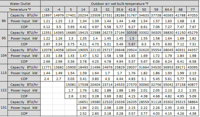

I just became aware of another more sophisticated small modulating chiller that might be of interest for keeping the floor warm, even if you still needed mini-splits to keep the place fully heated on design day:
Mind you, those are wet bulb temps- the outdoor air temps are warmer than that, but it looks like it might handle the whole load at your average January temp, depending on how much heat you get out of the floors with 122F-131F (50-55 C) water.
I'm not sure how it handles defrost modes, etc. and you'd have to use glycol to avoid freeze-up, which also affects heat transfer performance. Not a slam-dunk, but it's probably sorta-doable in an efficient way if you want to play Jr. Hydronic Designer and do at least all of the napkin-math on the system.
If you backed it up with an electric boiler you could do the whole thing with the radiant floor, but the system efficiency would go completely to hell if the chiller wasn't delivering at least 90% of the heat at your outdoor design temp.

I think I can safely say that I will have some percentage of my future heating needs delivered through the heat pumps that replace my ancient A/C unit.
Using a chiller like this one for the extra heating capacity (and cushy floor comfort) would be really interesting.
If the mini-splits work out really well, then I may only need marginal supplement with the oil-driven radiant heat. I'd like to ditch oil..... but that urge is directly proportional to how much oil I am burning..... if it is not much per season....
Of course, when the oil-fired water heater goes, then I would be forced to make a decision. By then I would hopefully know (1) how much excess KWH I am generating, and (2) how much (if any) I need to supplement the mini-splits.
At that point, a chiller such as this one or perhaps an htp pioneer? It seems that the heat-pump technology continues to improve (or perhaps just our manufacturing/pricing of a well-known technology) year over year. The performance charts you linked are very encouraging. As you say, it is probably sitting in the "sorta-doable" bucket right now. But if continue to see efficiency/capacity/range improvements......
