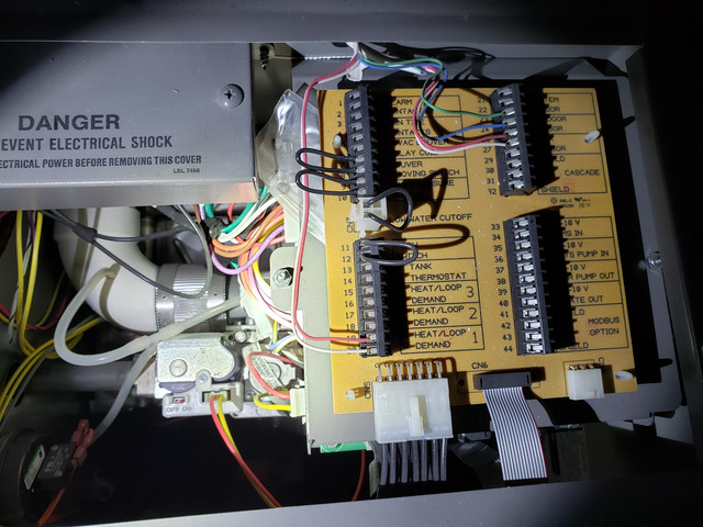

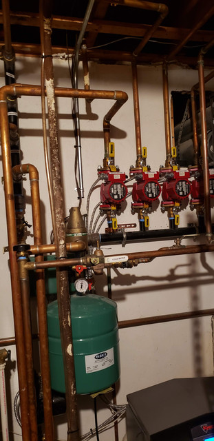

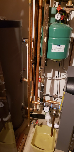

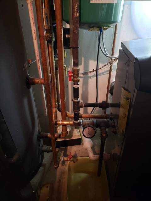

I'm a homeowner who's been struggling with the MRHL/ARHL issues on my Lochinvar Knight KBN-106 boiler since we got the house last year. I live in the Boston area so as the weather is getting colder and more demand for heat I've been having lockouts on a daily basis. Summer months are fine as there is only DHW demand lockouts only happen occasionally in the summer time.The boiler is connected to 4 circulation pumps. 3 for space heating and one for indirect hot water tank. I've drawn and attached a piping diagram for reference. I'm also including some photos and a video of one of the lockout situations.
At first the lockouts seemed random, but lately I've been trying to see under what conditions the lockout happen. I'm still not sure if its a specific thing but it seems that when there is a call for DHW it happens the most. What happens in a typical situation is that there will be a SH call and a DHW call comes. The boiler will switch over to DHW, but as its firing (typically at 100%) and trying to get up to the setpoint temperature, before it reached it will stop firing and there is some kind of noise in the boiler (can be heard on the video starts at 52 second mark) and the outlet temperature will spike up past the high limit and the lockout will occur. It seems that before the water reaches the setpoint (160) there is a surge of how water from somewhere that comes in and trips the high limit. Limits are set to 200 for ARHL and 210 for MRHL.
In certain occasions where there is no SH calls and boiler is in standby mode and the DHW call comes by itself it will modulate properly and not trim the ARHL/MRHL limits. However this is not always the case. At times it trips the high limit even if its only a DHW call. That's why I cant figure out the exact reason why it might be tripping since it seems somewhat random. I believe the main issue is that surge of how water coming form somewhere which increases the outlet temperature and trips the hi limit sensor.

I'm not clear which model KBN you have. A KBN160 is not listed in any of the online manuals- it jumps from KBN151 to KBN211. Or was that a typo- and actually a KBN106? see page 7.

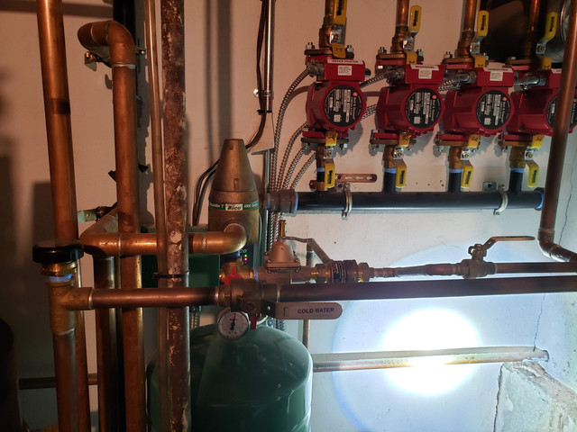

It's not clear where the Grundfos driving the primary(boiler) loop is located (is it internal to the boiler on this series?) or the tees that form the hydraulic separator. If the closely spaced tees are too far apart from one another or are too skinny, starting/stopping of the secondary pumps could interact too much with the primary loop flow, causing sudden slow-down and subsequent spike in the output temperature.

@Dana The boiler is a KBN-106. Sorry for the typo. The boiler pump is outside on the inlet side of the primary loop. I checked the spacing of the tees and they are under 4x the diameter. Basically next to each other. And the piping seems ok per the criteria you mention above. I ended up turning down the firing rate of the boiler and not getting as many lockouts now, however on SH calls there is a lot of short cycling.
In monitoring the boiler what I think is happening is that the boiler pump is shutting off before the burner shuts off. I'm posting another video. You can see the boiler firing rate modulating up according to the ramp delay and everything working fine until it starts to get close to the set point (in this instance 127*). However, when it gets up to about 122* you can hear the boiler pump shut off. The zone circulators are still running fine. So what I think happens is that the boiler pump shuts of but the burner keeps firing. The water in the primary is not moving and it heats up quickly in the boiler and and it shuts of the boiler and then you see the outlet temp spike. Reducing the firing rate has helped with the lockouts, but now its short-cycling because of this problem. This is the sequence that keeps happening boiler pump goes off ... boiler still keeps firing ... boiler heats up water that's not circulating in the primary loop ... water gets too hot ... boiler shuts off abruptly .... pump comes on after a little bit ...it cools down the water below the set point and boiler fires up again and it starts all over
Why would the boiler pump be shutting off early? That doesn't seem like normal operation.
