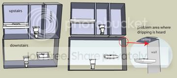

Not sure what to do here and newbie to the forum. I have a shower stall upstairs and no noticeable leaks that I can see. On the floor below that stall is another bathroom. When the upper shower is running, you can hear what sounds like water dripping onto the ceiling of the lower bathroom near the corner of wall and ceiling.
Once the shower has stopped, you can still hear the continued dripping until of course it finally stops. So how do I diagnose where the leak is coming from and what do you think could be the problem?
The upper stall is tile walls and floor with the drain in the middle. No tub, just a stall. Maybe a fresh bead of caulk around the floor edge and drain?
Thanks in advance.
