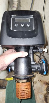

While I'm still debating what to do with my system to treat the iron, can I clean this valve head and bypass to give me some time? I have new KL media and gravel.

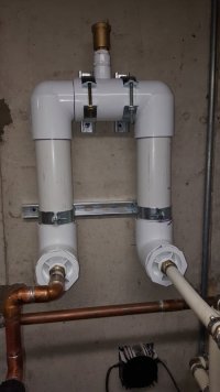

Regarding my iron filter valve replacement, from what I can gather, AIO would help but possibly not 100% plus it puts air into my pipes and sputtering at the taps frequently, which I don't really want. It seems installing a low velocity loop between the iron filter and softener would get rid of the air which I could do. This looks like the 1" exit from the iron filter would go into this 3" loop and back into 1" for the softener input.

You have them ready to put into the media tank, or you already put them into the tank?
Usually you would remove the top basket. What is your backwash rate and what is your tank diameter? Many people have too-low of a backwash rate. Even with a good backwash rate, the top basket should not be needed. At least your top basket has relatively course slots, and is not totally clogged.
You could rig up something to circulate an Iron Out powder solution thru the places you want to clean that way. https://www.menards.com/main/grocer...er/io10n/p-1444444183163-c-7097.htm?exp=false
I don't expect that to rejuvenate your KL media; at least it did not rejuvenate my Centaur Carbon.
It would have been impressive if the right port of that bypass looked as it does, and the left port was clean.

Are you saying I don't need this part on the valve?
Yes. Removal may not be that easy.

I was able to remove about half of that stack easily just by a quarter turn. I didn't really try the remaining ones. What's the purpose of that stack?

- AIO (with low velocity loop); would require new valve

The recommended backwash rate for KL media is 10-15 gpm/ft2, so, for a 10" diameter tank, this calculates as 5.4-8.1 gpm. Although your 6gpm drain rate is within that range, that is at the low end, so suggest increasing the drain flow rate to 8 gpm.
In addition, the ferric iron accumulation on the upper basket screen, will have been reducing the flow rate during the backwash cycle, so the actual drain rate may have been significantly less than 6 gpm. Recommend removal of the upper basket, to instead utilize an 'umbrella' style diffuser mounted to the riser tube, further down below the control valve within the freeboard space above the media. A diffuser will not impede flow during backwash, but will deflect and spread the incoming service flow across the top of the media, thereby preventing the media directly below the control valve's water inlet from being eroded and washed outward to the side wall of the tank.
