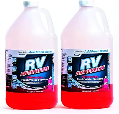

The simplest and most effective solution would be to pour some RV antifreeze into each drain before leaving. It will not evaporate so your traps will continue to be effective. It's completely non-toxic and harmless to your septic system.
