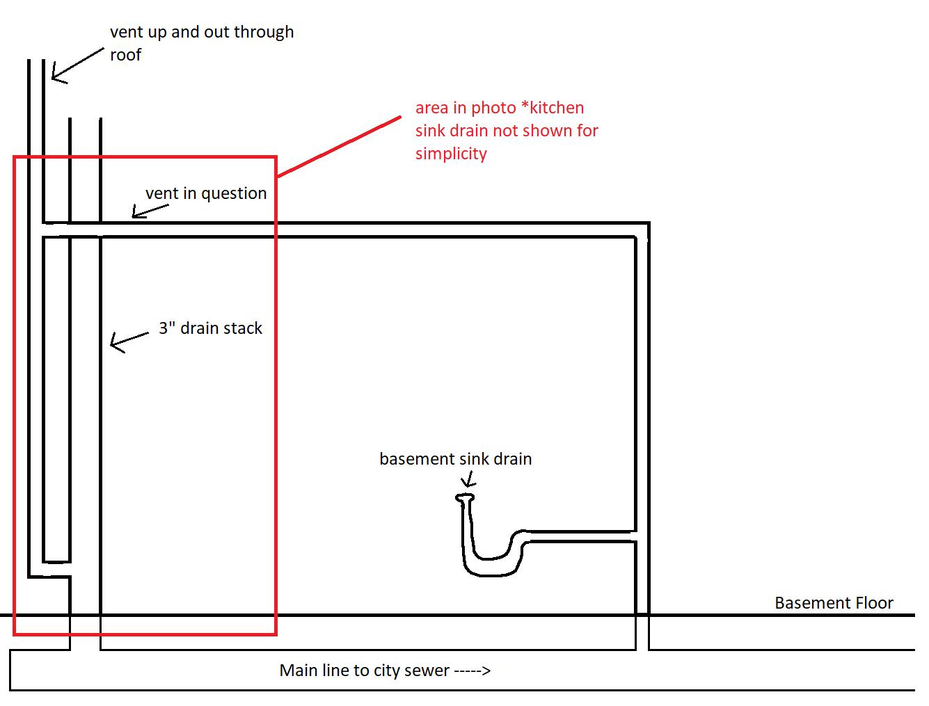

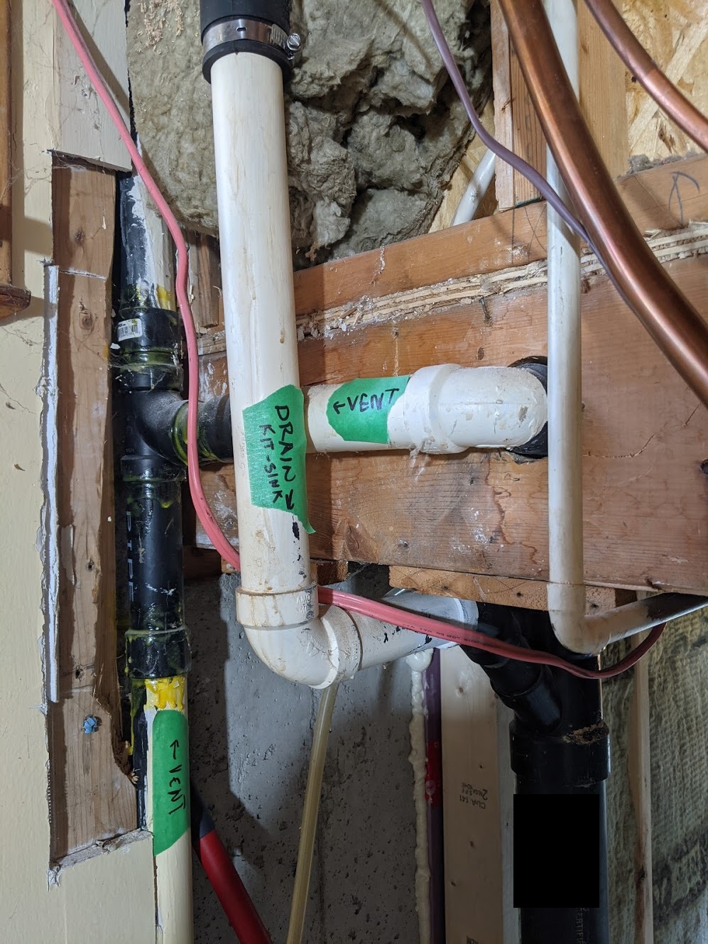

I'm in the process of trying to "flatten" these two runs into the same plane so they can be framed inside 2x4 wall. I cannot build bulkhead around the whole mess, as there is a window right there. The copper AC lines will be removed, as will the red wire. This is what's holding me back. I will also be moving that vent run off the concrete, so it's more inside the house.

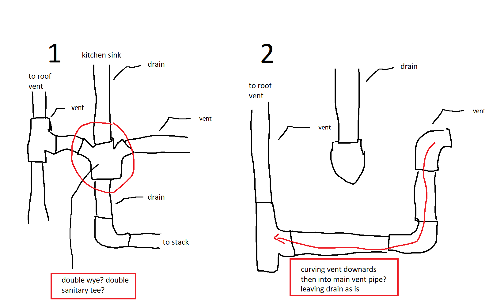

I was wondering if a double wye/tee would work in this instance (or some kind of cross) to combine the drain and vents into the same run. I'm trying to eliminate the overlap in the photo.
The other thing I could do is perhaps run the vent downwards below and around the drain into the main vent stack - but that just feels wrong.
Please review the photos. Thank you very much for your help!

#1 definitely doesn't work. You can't interrupt your vent with a drain flowing through it, so you basically can't cross a drain and a vent in the same plane.
#2 might work, I'm not familiar with the details of the Canadian Plumbing Code. One of the US plumbing codes (UPC) requires a vent to be pitched back to the drain(s) it serves, so it wouldn't allow #2. The other (IPC) just requires a vent to be pitched back to some drain, so it arguably allows #2. Where the new lower horizontal vent segment would be pitched down and to the left (so your san-tee wouldn't be upside down).
A few more possibilities (not sure if I fully follow the overall context of your close up photo):
- Can you jog the kitchen drain above the existing horizontal vent into the wall/floor framing behind the horizontal vent, and reach the lower vertical drain section that way?
- Or can you jog the vent within the floor framing to come out to the left of the drain?
- Or jog the kitchen drain to the right (possibly along with jogging the vent to the left) so they don't intersect?

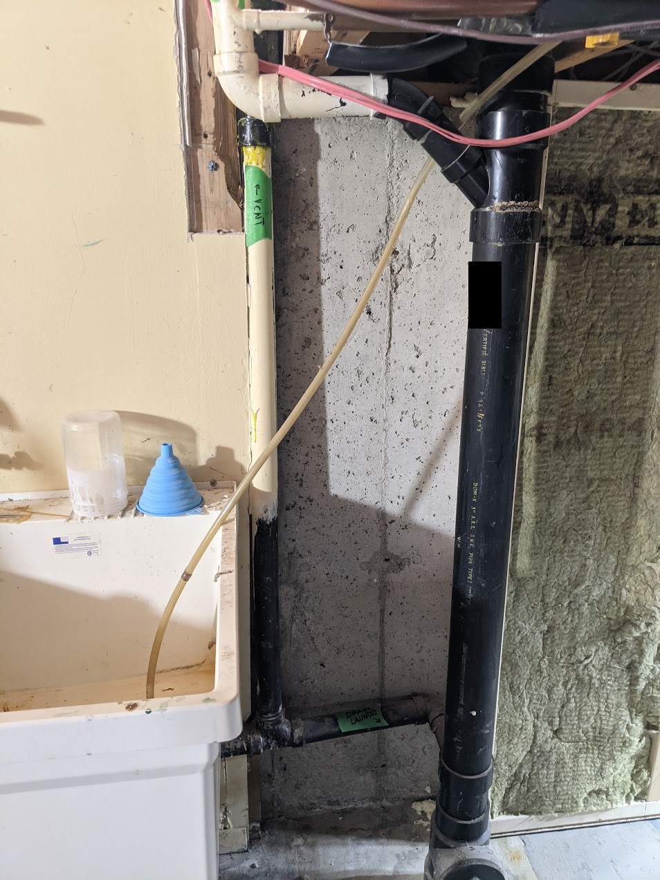

2) The vertical vent on the left (which runs up through the roof) - the lower portion of that ties into a drain for the laundry basin, which ties into the main 3" drain stack (see photo below).
The other weird thing is that the vent that I'm trying to move (from the first photo) - comes from a bathroom sink on the whole other side of the basement. The drain itself for the vent I want to move is a good 3-4 feet below the vent. Here is drawing and a photo showing more information.
As far as jogging things behind/around - that 2x12 is sistered, and holds up the second floor (side-split). I really want to avoid cutting 2" holes in it if possible, especially so close to the foundation on which it's sitting.
Jogging the kitchen drain to the right, I like that - but I don't really want to cut into the 3" stack to rotate the feed to the right. I also don't want to create a zig-zag of 45's and 90's where the kitchen sink goes to the right, then zigs back left into the 3" stack. I mean, if that's the way I have to do it I'll do it - but I was looking for something neater (it also just feels wrong to zig-zag a drain - I figure the less bends the better).

In that last photo, how about the following for the kitchen drain:
That 45 next to the wye, turn it so the inlet is facing up. Then going upstream, the drain rises up alongside the double 2x12 until it comes through the subfloor, then hits a 45 to turn up and to the left, then another 45 to hit the existing kitchen drain.
I can't quite tell what is going on above the subfloor, whether that routing would be through an exposed area or if there are obstructions there.
BTW, in the US at least, that rubber coupling should be a shielded rubber coupling; the unshielded kind are only rated for below ground use.
