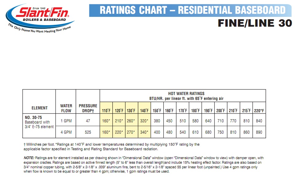

Are you sure you have enough baseboard to heat the place with 130F entering water temp at your 99% outside design temperature? The heat load of a 2300' raised ranch on Long Island is likely to run in the 25-30,000 BTU/hr range, lower if it's tighter and better insulated than average. It would take on the order of 125-150' of typical baseboard to emit that much heat at an entering water temp (EWT) of 130F. Run your fuel use load numbers and measure up the baseboards to get a handle on the storage temperature it would take on design-day.

Is there any way you can combine some of the micro zones so they meet the minimum requirement of say 8K BTU's with 110F water? Use 160BTU/ft of fin tube element for your calculation.
There's generally no savings micro zoning four upstairs bedrooms for example when they can all be on one decent size zone that will let the boiler operate at low condensing temps.
Third... your radiators were sized to heat your home using 180F water, 170F AWT (Average Water Temp) radiates 510 BTU's per ft of heating element. A 2,300 sq/ft home could have 46,00K BTU's heatloss- that would need 90' of fintube at 170F to make up for lost BTU's at 15F outdoors. If you run 120F water (110F AWT) through that same 90' of fintube you now get 9'900 BTU's output. Your house will be very cold inside. You will need to add more radiation (where you can), replace standard fintube with low temp fintube and or run the mod-con at higher temps where it will not be condensing any longer and will be at or below 90% efficiency. Hopefully you'll be over-radiated like most homes and the numbers will be workable.
