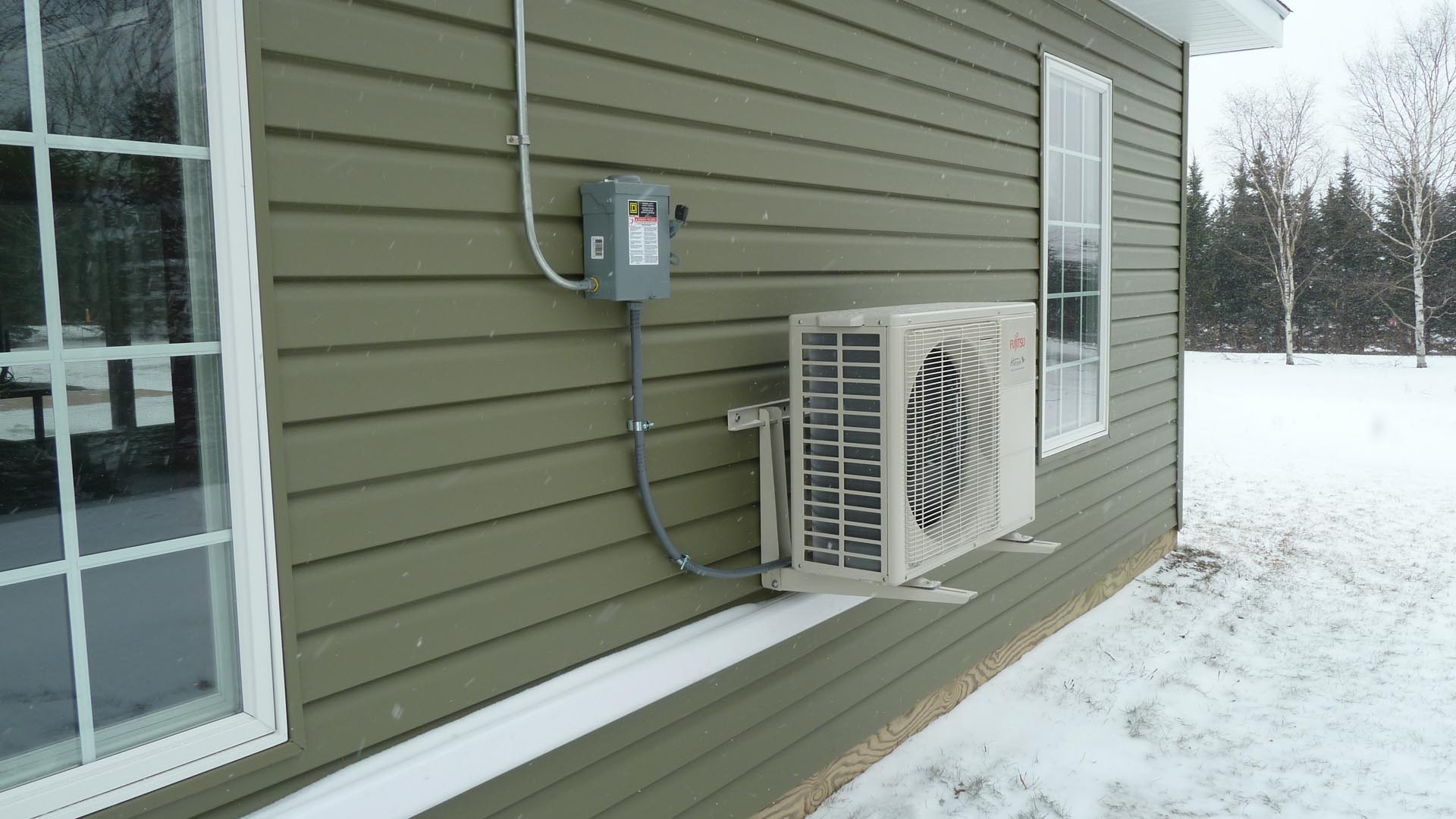

Where and how you mount the compressor unit matters, since you do get hit with the occasional blizzard. Bracket mounting it on an exterior wall above the anticipated peak snowpack depth, protected by roof overhangs is best-practice. Don't count on eaves to protect fully- under the rake of the roof is better, or you could end up in a situation like this, despite 2' overhangs on the eaves:
Most manufacturers have customized bracket mounting packages- but even if they don't, it's still possible to make up your own. This is what Fujitsu's bracket looks like:
