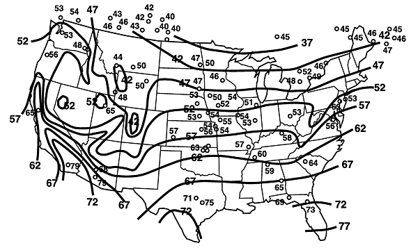

It's worth installing 3/4" EPS (R3-ish) which is enough to keep the subfloor above the summertime outdoor dew points (most of the time), which will keep the subfloor from rotting and minimize mold risk in the carpeting even if you don't do much mechanical dehumidification. With out the foam the dehumidifer is a must.
Deep subsoil temps in your area are about 55F, outdoor summertime dew points are above that mark 90% of the time.
But with R3 under the subfloor & carpet the subfloor will be pretty near room temperature, and won't be taking up moisture from the room air, even if it has R1-R2 of carpet or other flooring above it. Even half-inch EPS (R2-ish) can be protective of the mold-susceptible materials if the flooring is wood laminate.
Since the subfloor is fully supported by foam & concrete everywhere, it doesn't need to be 3/4"- it's not a structural subfloor the way it would be if spanning joists. Tack the EPS to the concrete with thin beads of foam-board construction adhesive, then a layer of 6 mil polyethylene over the foam. Half-inch CDX or OSB sheathing is usually a sufficient subfloor for flooring fasteners, even for hardwood flooring. Keep a foot of overlap of the subfloor seams relative to the foam board, and Tap-Con the subfloor to the slab 16" o.c. or tighter. Walk around on it a bit to test it, and apply a TapCon any bouncy sections to keep it from moving.
Leave 3/8" - 1/2" gap of the to any walls to allow for seasonal expansion and lap the poly sheeting up the edge of the subfloor (or up & over, stapling it to the top.)
If it's known that there is a plastic vapor barrier under the slab (likely, for a house built in the 1990s) it's possible to skip the polyethylene sheet and glue the subfloor to the foam. It still has to be secured to the slab with masonry screws to avoid "potato-chipping" curls and waves with seasonal humidity changes, but it's a bit easier than dealing with polyethylene between the foam & subfloor.

With any finish flooring over a slab there needs to be some sort of vapor barrier to keep ground moisture at bay, and that's even more true if there is a wood subfloor under the finish floor, and a mold susceptible carpet. The air in the soil under the slab is pretty much at 100% relative humidity all the time, even when there isn't liquid water at slab level, and the moisture drive is always from the soil toward the drier air of the conditioned space- the finish flooring never dries toward the slab. Six mil plastic (between polystyrene insulation & subfloor is best practice, between slab & polystyrene insulation is usually OK) is a cheap & reliable vapor barrier. As long as the seasonal average temperature at the bottom of the wood subfloor stays sufficiently above the seasonal average dew point of the conditioned space air, the moisture content of the wood won't reach mold/rot supporting levels.
The deep subsoil temps in MD are well below the outdoor summertime dew point averages, and the sensible cooling loads of basements are low, so there isn't a whole lot of help from the AC to keep the basement air sufficiently dry. Putting even R2 foam between the subfloor & slab raises the average temp at the foam/subfloor boundary by quite a bit, lowering the average moisture content of the wood.

And that's true, depending on what your subsoil temps and summertime outdoor dew points really are. R3 is somewhat conservative, and works pretty well even in colder climates with with subsoil temps in the low 40s or high 30s.
The amount of air conditioning/mechanical dehumidifcation makes a difference too. The dew point of 40% relative humidity 75F air conditioned air is about 49F, which is probably cooler than your slab temp, and way cooler than foam/subfloor interface that matters, so there would not be a moisture accumulation or mold risk even without the insulation. But 60% RH @ 78F room air has a dew point of 63F, and need at least some insulation to keep the bottom of the subfloor from getting moldy in an area with subsoil temps in the 50sF. Local outdoor air dew points in most of MD average in the mid to high 60s during the peak weeks of summer.
If the house is NOT air conditioned during the dog days of summer and you rely on throwing the windows open at night it might still need R3 under the portion with the rug, since rugs are insulative, lowering the temperature of the subfloor.
