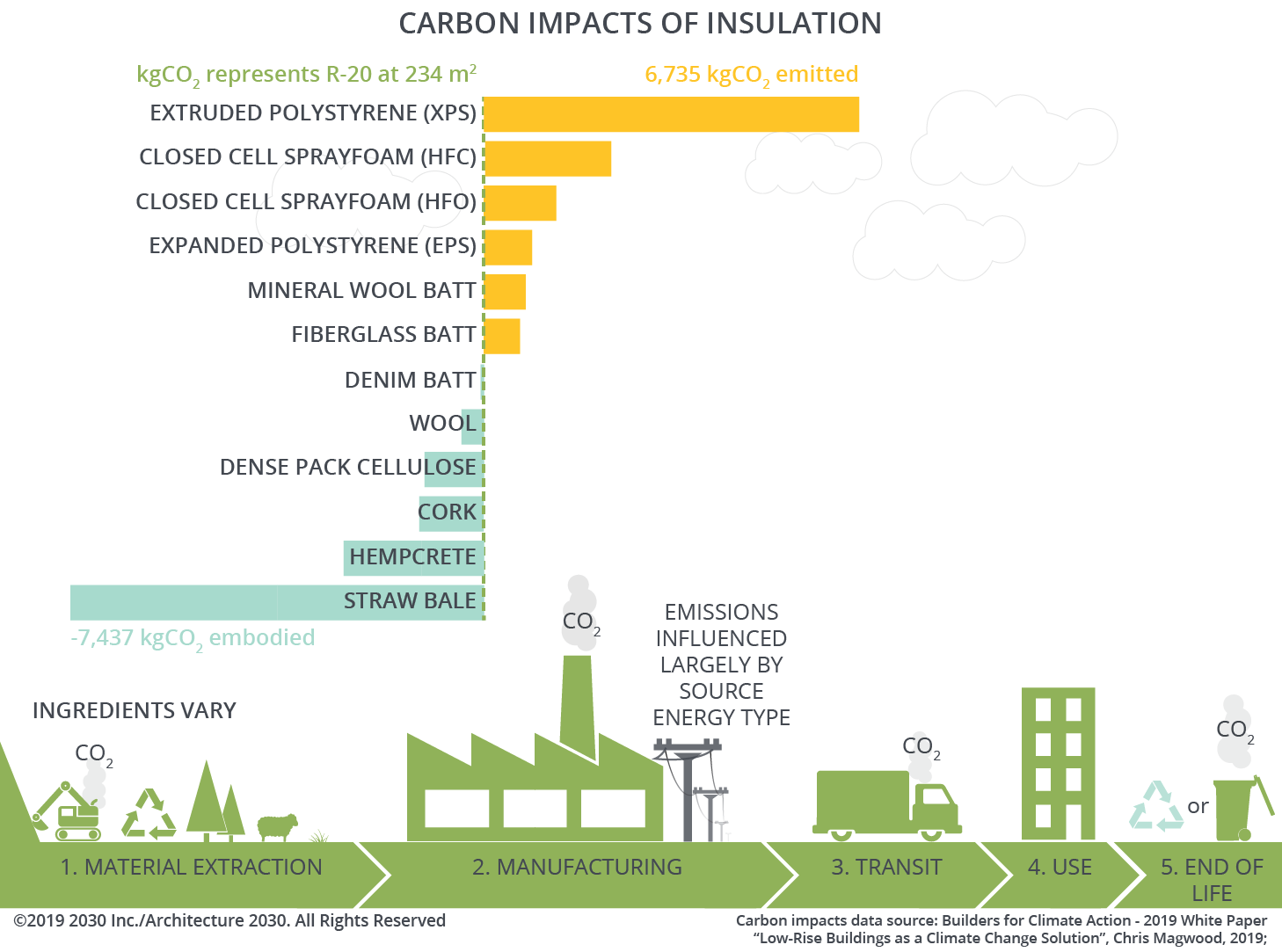

Friends don't let their friends use XPS (eg Foamular 150). The reasons are twofold:
*XPS is blown with an HFC soup blowing agent which gives it it's higher initial performance, but as the HFCs diffuse out over decades it's performance drops to that of EPS of similar density (in the Foamular 150 case, R4.2/inch). While it's "warranteed for life" to 90% of the labeled R, they're counting on never having to pay off on that, since it'll take 30-40 years.
** Those HFC blowing agents are EXTREMELY powerful greenhouse gases compared to the low impact isopentane used for blowing EPS. The differences in lifecycle CO2e footprint isn't subtle- XPS is by far the least "green" insulation material in common use today:
