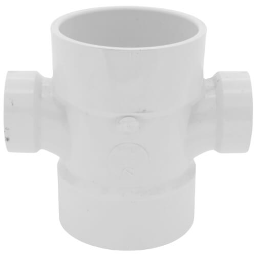

I'm hoping for some advice removing a tee currently in place and installing a new 3 x1.5 double Sanitary Tee. This is the main vent on our house (single story ranch), the 2 inch pipe on the left is a vent for a basement rough in that ties in to main vent 40 or so inches above the floor. The work is for a new double vanity.
With the tight fit of the current Tee is there any cutting options besides a wire cutter/string or a multi tool? I'd prefer to keep the drywall on the other side hole free. I'm assuming there is no support the top section of pipe and I'll need a riser clamp in the attic and the bottom portion in the basement will need a strap or similar.
To install the new double tee what is the preferred method: to glue stubs into the new fitting then use banded couplings or glue PVC slip couplings over the new stubs and vent pipe (if they fit)? Or some other super easy option I don't know about?
Is there any issue with the 2nd drain stub out on the left being placed in-between the 3 inch stack and the 2 inch vent or to rephrase is there a minimum length the pipe needs to be going to the double tee. There is roughly 5 inches between these pipes.

I'm a bit unclear on the double sanitary tee vs double fixture fitting issue in the context of lavatory drains. But there's no 3x3x1-1/2x1-1/2 double fixture fitting in Charlotte's catalog, so the double sanitary tee may be the only option there.
You can put a street long turn 90 in the left hand inlet on the double sanitary tee if that puts your wall entry where you want it.
If you want to go with Reach4's idea, you still only need two rubber couplings. You'd just cut out a taller section of the 3" pipe, and put one rubber coupling above the vent wye and one below the drain wye.

https://www.supplyhouse.com/Spears-P429-337-3-x-1-1-2-PVC-DWV-Double-Sanitary-Tee if you wanted that.

Thanks for the link that is the fitting I ordered a few days ago.

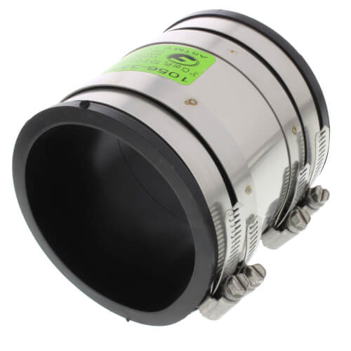

Are shielded couplings similar to this ok to use in this situation. I am beginning to think they are not ideal for this project.

Shielded coupler is close enough to ideal. Dish soap is commonly used to lube for easier sliding of rubber on pvc.

Those couplings are no hub couplings intended for cast iron to cast iron (and you got the extra heavy version with two band clamps on each side). In 3", cast iron is a smaller outer diameter (3.35") than plastic schedule 40 (3.5"). So they are not quite the right size, perhaps you had a little trouble getting them on. The proper coupling to use is a Fernco 3005-33 or Mission P-300. I imagine there's a good chance your couplings would work fine, but I can't really say.

I think you are right about the couplings. The Amazon listing made it seem like they were for cast iron and/or pvc. I guess that was just Supply Giants stock number, had they listed the actual part number I probably wouldn't have ordered them.
My Home Depot was out of the 3005-33 when I was looking so bought a P1056-33RC knowing it probably wouldn't work. It was much to thick to fit in the wall, I think 4.25". I liked the idea of the 4 clamps for whatever reason so the Amazon listing seemed great when I found it.
The rubber actually slid on the pvc fairly easily. Folding over the loose rubber so I could get the tee in was the trickier part and that was mostly because of the finished drywall side. But even that wasn't to bad. I wish I would have taken a few pictures. I'm pretty happy with the way everything fit together with these couplings so I think I'll try them out.
I'm out of my element with the couplings and there are a bunch to choose from. If it's not to big an ask would you mind explaining the difference between the no hub couplings and any type used for both cl/pvc? I've tried in vain to Google an answer.
The P1056-33RC list plastic, cast iron, steel and lead and it was just perfectly smooth inside.
The no hub Everflow has little ridges and seems like it would seal better. It looks similar to the inside of the fernco 3005-33 from the pictures I've seen. Maybe the fernco is thicker?
