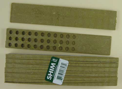

4- Set the toilet bowl on the flange without wax, to see how the floor is.​
Determine if any shims are needed.
I prefer to shim at the back, pinning the front of the bowl down.
We use the composite shims located in the windows and door section of HD.
