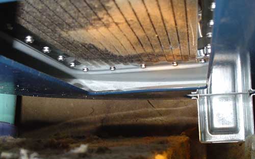

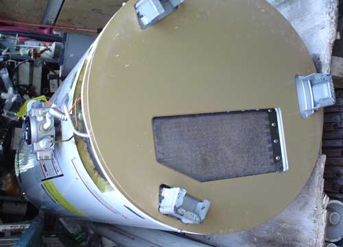

Flame Locks ARE PIECES OF JUNK
I am presently repairing about 2 -5 of these dogs a month...
for an average of $250 with me supplying parts
go look at my web page to see what is wrong
with this brand of water heater.......
you got to clean the bottom of the heater screen
or all your troubles are in vain.........
These units need to be cleaned about 3 times a year
becasue they suck up lint and hair like a vaccuum sweeper...
its all there with actual pics of the problem.....
just scroll down to the WHIRLPOOL SECTION
with pictures
and its all there for the world to see

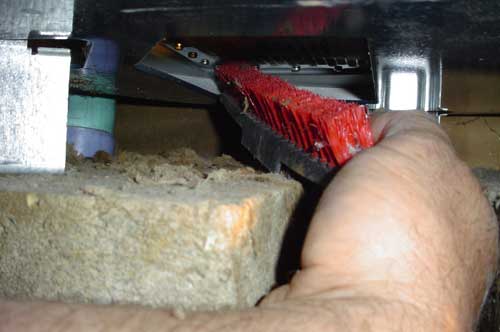

free advice for you
you got to clean the air intake from
underneath with a steel brush and clean
the inside screen too.....
or your repiars can literally all be in vain within
an hour of the repairs....
I dont know if I would even warranty the repairs for more than
30 days.....
I had one go bad that was 9 months out
from my original service call... what do you do for them??
you can get the parts at lowes...for around 85 bucks....
the only sure cure to their crummey unit
is to get more air into the unit somehow....
thats really pretty simple to do,
but that is up to you to figure out....
dust, lint, cat hair, dog hair, people hair.....ect

After reading the horror stories I put a strip of Honeywell air filter pre-filter mesh around the bottom of my Whirlpool. So far so good. After looking at the pictures I am thinking it might be worth a try to clean the bottom filter with a propane torch, at least that would singe all the lint to ashes. (This is not a reccomendation as I have never tried it) RW
Master Plumber Mark
5,533
354
83
www.weilhammerplumbing.com
dont try that
I would not try burning off the lint or
dirt with a torch........you might melt or afix the dirt
to the screen.....
or singe off your eyebrows.....
here are some pics of a praticulary nasty dirty one I
just tangled with last week....
I AM SAD TO REPORT THAT I LOST---------AND IT WON..

I also tangeled with one 3 weeks ago. What I did was attatch a 1"
90 to the end of a vacume with duck tape and slowly went over the air intake area which was clogged with lint/dust. This worked great and cleaned the screen completly. Replaced the thermocouple and we were off to the races.
