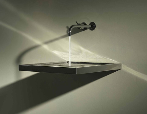

I think they (original owners) wanted to install some kind of 3 hole wall mount faucet... something like this (but 3 hole, instead of 2)
I see Danze sells many wall mount faucets, but I don't know which one will fit our set up (if any)
For example, can I buy this one?
