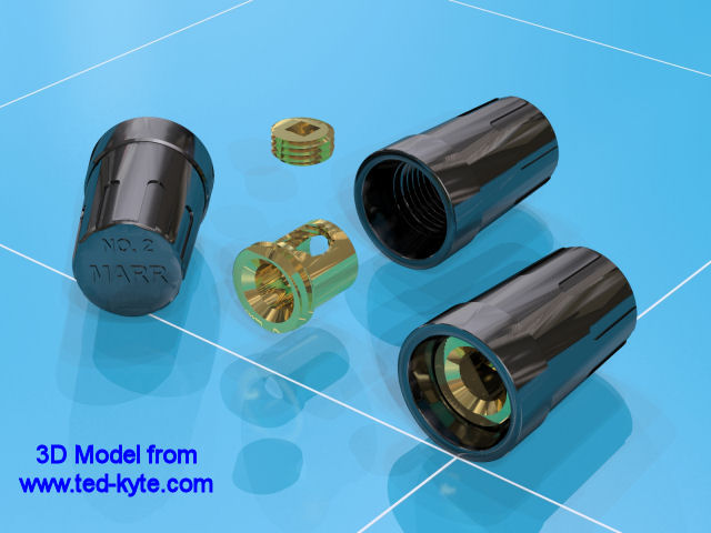

I don't know what you mean by "wire tie the two wires". I like to use Marr connectors without any tape.

Using heatshrink splice on the topside makes it more difficult to pull the pump as you either have to cut the wire or cut the tape holding it to the downpipe. Mind you, I don't think the OP has pulled that pump ever. Over the life of my well, I've pulled my pump probably a dozen times. At first I was using wire nuts but they are not well suited to re-use so I would lose an inch from the leads each time. I switched to the above Marr connectors and tinned the stranded wire so it wouldn't fray.
